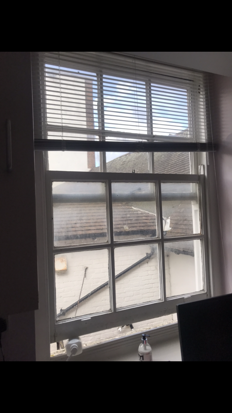

We have what I believe is a sash window (the sliding up and down wooden ones), after taking up a tenancy on a first floor office. The window doesn't stay up and is quite heavy so have to jam something underneath to keep it open. Looks as if a rope on the right side has torn away.
What is the process to get this fixed and how much would it typically cost. Based in Hertfordshire.
Can see the string / rope has snapped on the right side

Is the top sash fixed or sliding? Is the complete window assembly timber or plastic?
If the answer is timber then you need to find a carpenter and joiner who understands Box Sash windows as there is an amount of deconstruction to do. Make sure the pulleys run freely.
If the window is plastic then probably/possibly your commom window fitter may know how to solve the problem.

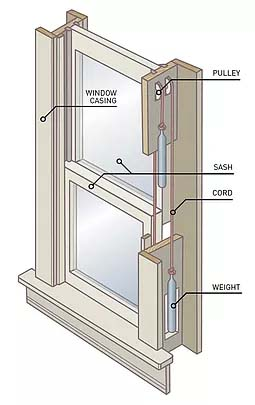

Do not rely on the pic in Post #5. Some Joinery details & names of parts are missing or plain wrong as anyone experienced in joinery would have instantly seen.
The pic shows a US frame.
OP, with best practice you would have to release/remove the top sash to replace the cord.
You really need to get a joiner to do the job - if its an old box frame then both sashes should be removed & worked on at the same time eg. replace all cords.
Costs, who knows - anything from £100 - £200/hour min a half day.

The outline in the link will give you an idea of the work involved. Please note the edit to my previous posting above. I'd expect the cost to repair one window in London by a 'one man band' C&J not more than £500 for a full day including parts and parking.

And I must apologise to the OP for providing the simplest image I could quickly find, to demonstrate the point, that they have answered their own question. The cord snapping has probably got something to do with the window not staying open, but given my lack of joinery knowledge, I'm probably wrong there as well!
I must also apologise for the picture containing merely five words, all of which are just plain wrong!
