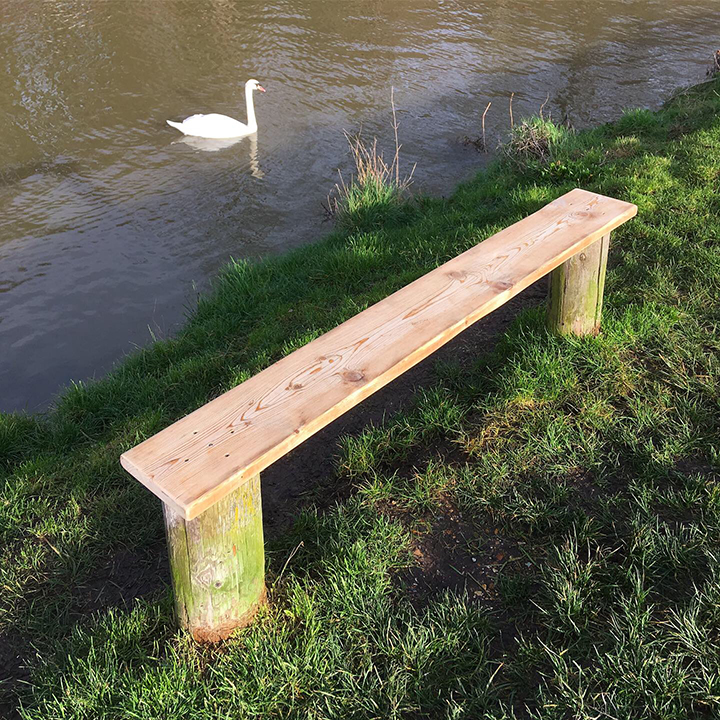

Thanks all for the advice. Went with a 38mm scaffold board, sanded all over, painted with two coats of clear preservative, and fixed into place with five 76mm screws into each post.
