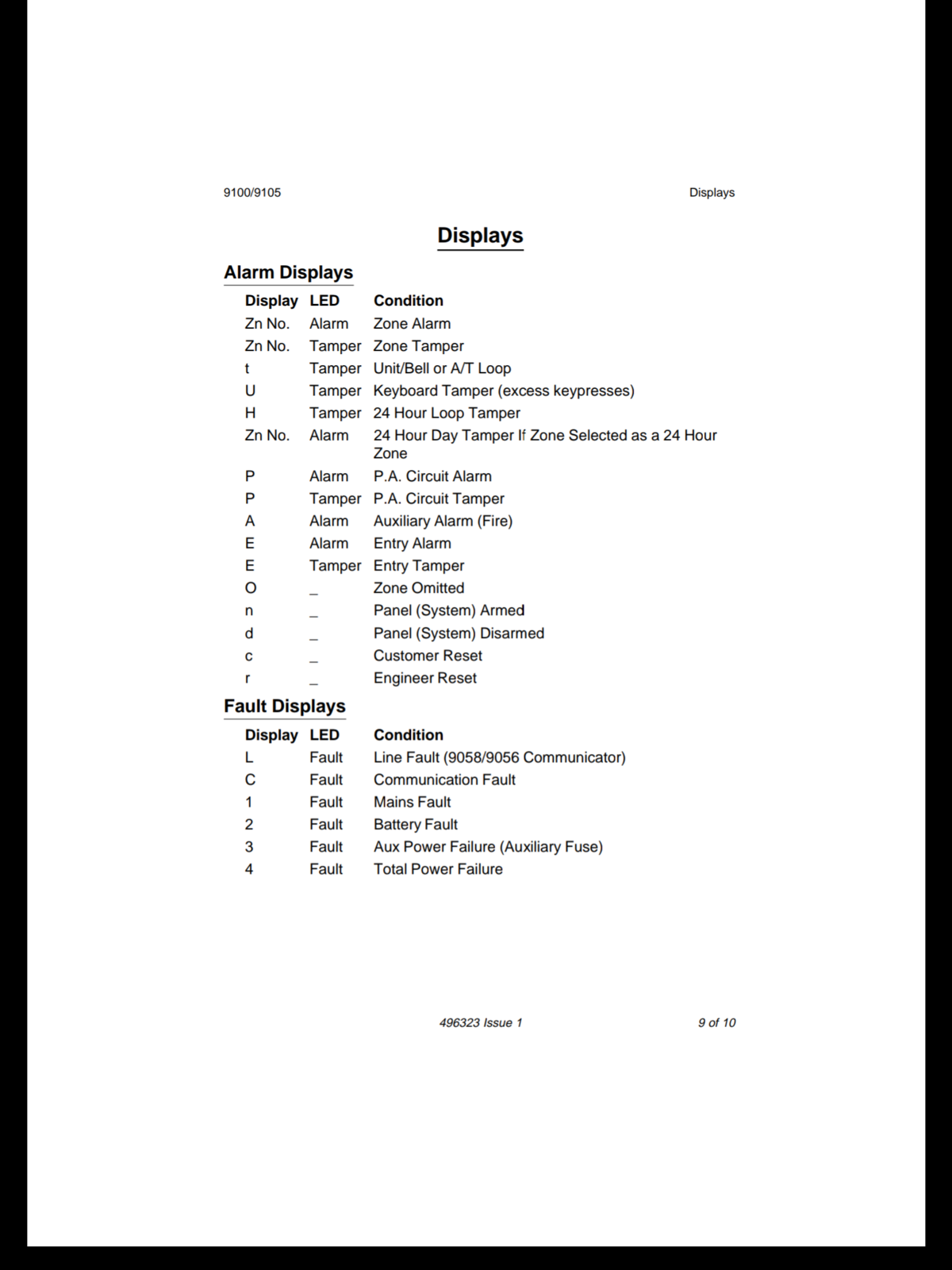

Hi,
I had a Modern alarms Series 3000 box (Scantronic 9100) install around 15 years ago by a mate that worked for Modern Alarms (unfortunately no longer with us)and it has been very reliable with hard wired sensors on doors and windows. The alarm box became very rusty so I took the sounder out and put it in a new box now I have call Engineer & Tamper lights on which I can not clear even with an eng reset. Tamper is wired the same as before the problem !

Have you checked the control lid is on correctly.
From engineering mode put 97 enter into keypad and check what is displayed in display .
Check your display with above.
You could put wire link between TR and OV on alarm pcb.This will link out tamper on bell box and prove if bell box is wired correctly .
Hi Everyone,
Thanks to handymanjo for a very fast reply. Pleased to say i have solved the problem, when I took the old bell box off it was a very dull day and in my notes I got a grey and white wire muddled up :( on the tamper circuit !! Everything now working apart from my brain:sleep:
