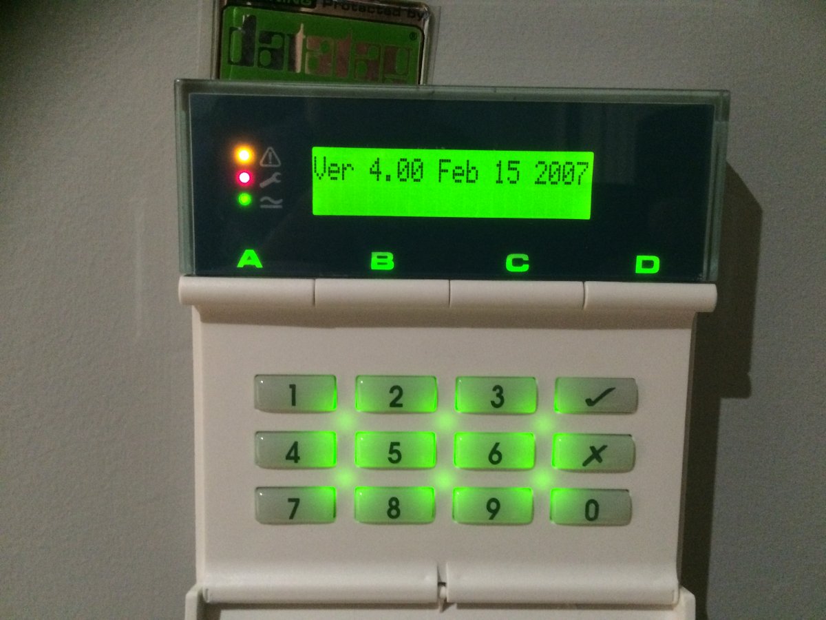

Dear All,
I have been using my system for a few months with no issues
I added an extra keypad and the games began.....
I am basically unable to get out of engineer mode as there is a code X21:
Doesnt matter what button I press cant change
Any ideas please
I have searched google, manuals etc just cant find anything
Any help appreciated
Suggy
Sounds like your stuck in a menu ? Did you address the new extra keypad to number 2 ?
Hi, I have disconnected the keypad and still error. I was going to have a go at it again Friday. I agree sounds like it must be stuck but no idea how to get out of it
Thank you for your response
Suggy
Hi
Sorry, yes I did
I have just checked and I have escaped from engineer mode....... very odd, no idea what happened there
I will have a go at setting it up again Friday
Thank You very much for your mail
Spoke to soon...........
all system is now stuck showing faults and tamper. all lights on keypad lit up
Oh my head................
Ta
Power it down completely, both mains and battery, leave it for about 30 secs, then power up battery first, then try again
Hi
Just just tried it as fed up last night....
No joy
Press button - 99 - and it peeps but after about 6 or 8 button presses the peeping changes sound? if that makes sense
Uploaded image of keypad
Sys
em back to original state
99 does nothing
99 then the Tick button exits Engineer mode
