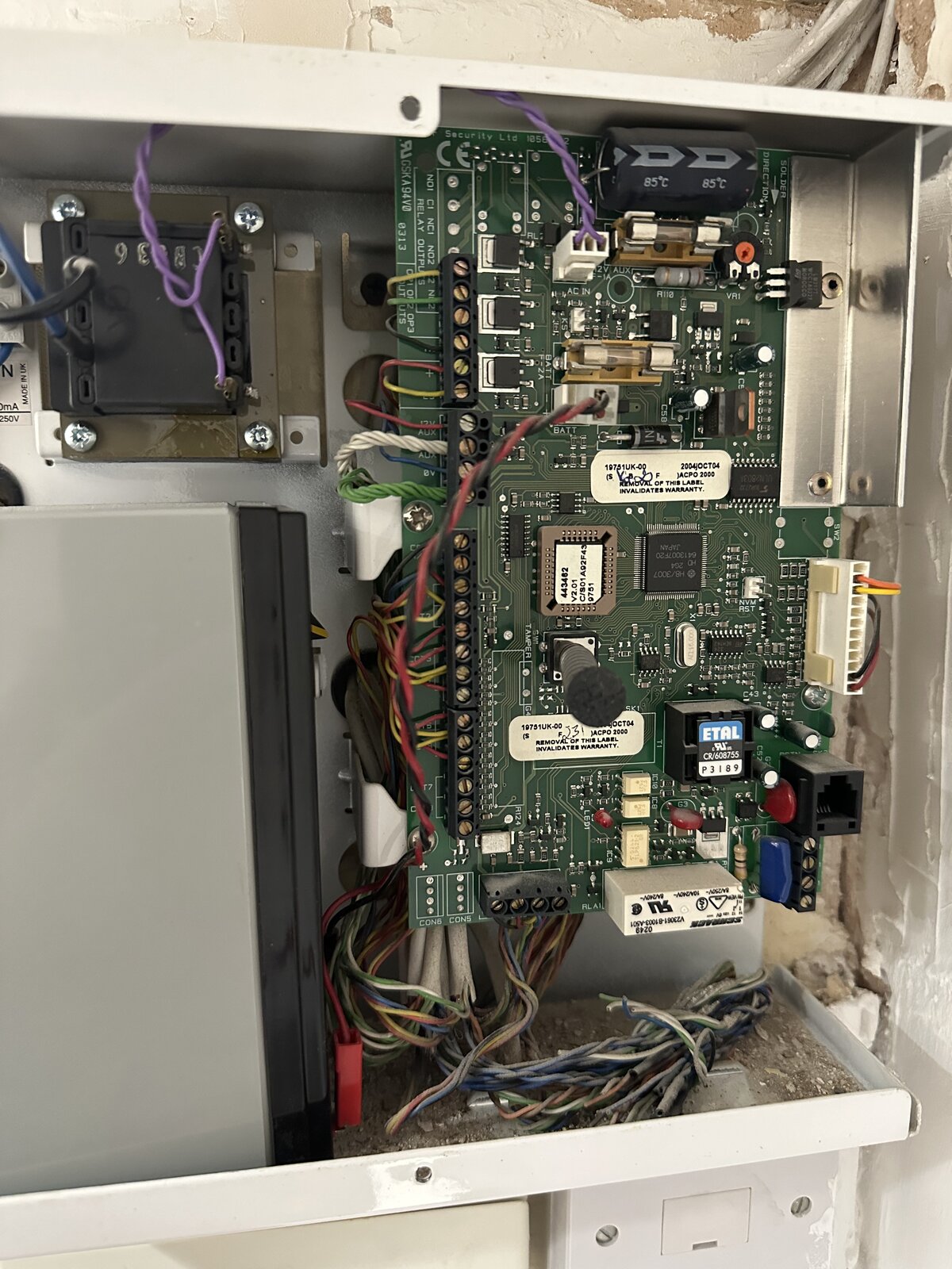

Hi all,
Hope I could pick your technical brains, I am a carpenter by trade however I have some limited and extended knowledge in other areas of construction work - alarm panels is one of those limited skills, by limited I mean no skills!
I have a basic understanding of how alarm panels work however its theory so you will need to be specific with your replies please.
In simple there are 2x cables (external sounder and room motion sensor) which are running visibly on the skirting board in the backroom. This alarm was installed well before I bought the house. Now that I am refurbing that particular room I want to hide those cables into a new partion wall.
Previously I reset the main engineer code so have seen the inside of the panel, at that time the decorator removed a sensor from the office/study (without me knowing) and then shorted the cables as he is removed cables from the sensor housing as he wanted to fill and paint behind the sensor. I believe from memory the AUX fuse had burn't out so that was replaced after the sensor was wired back up and the system reset and worked fine. After that I also installed a new battery some months later.
I made an assumption (don't shoot me down) that removing the AUX fuse this time around will allow me to remove the wiring from the sensor in the backroom so I can reroute it but once I remove the fuse the external sounder goes off, putting the fuse back in stops it. The cables will have to be removed from the panel and then rerouted and brought back, I can not access the wiring from the backroom sensor or external sounder due to access issues.
No way am I assuming anymore and would like professional guidance, I believe its a quick fix and the local alarm engineer can only come out next week for non-emergency appointments, hence my question to you all.
Sorry for the insight above hopefully it helps somewhat, but in simple:
1) Which cable is for the external sounder? - For the motion sensor I will just follow the room sensor cable and figure out where it connects in the panel
2) How can I remove both of these cables without the external sounder going off?
3) It is just a case of reconnecting once rerouted and then perform a reset?
4)If for whatever reason the rerouting takes longer than expected, can I just leave the panel installer mode for a few days or if I am going out can I reset the alarm so everything else works besides the backroom sensor and the external sounder - I do have a internal sounder.
I would be grateful for step by step instructions as I can not wait for the alarm guy and as mentioned I have reset the engineer code in the past, so once popping in the code and entering installer mode and removing the panel, I am lost!
Many thanks in advance, really appreciate your input, see the pic below of my panel
Jay

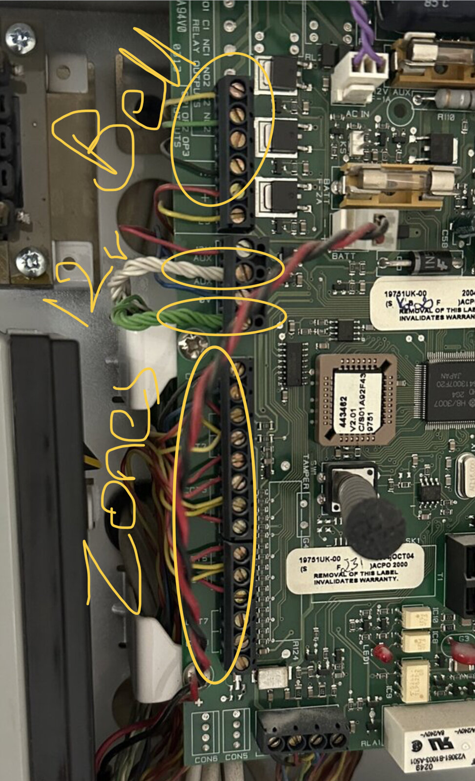

Hi Tiger, thanks for that. Just to clarify to remove the sensor, just simply remove the red, yellow, white and green cable for each sensor i want to reroute?
Unfortunately I can ignore the bell (external sounder) as i need to reroute that cable too as mentioned above.
Would be grateful if you have the solution for the removal of the bell wiring to reroute it without the bell going off outside
Thank you.

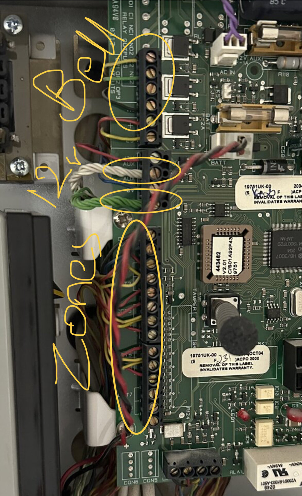

Bell will only sound for 15-20mins if the battery inside it is still healthy once the power to it is removed
Thanks Tiger, shall i just remove the 5 connections you labelled at the top?yellow,green, black, red and yellow. Guessing all of these 5 strands are within the core of the bell cable?
Was hoping there was a way to not sound the external sounder at all. I live with many elderly people on my street and i know they will all come running out!
Surprisingly when the decorator blew the AUX fuse in the past the outside bell did not sound or the internal sounder and it was in installer mode then.
Thanks in advance.
I’d guess your top 3 cores then the lone 12v + and -. Best bet would be to trace the O/P cores I labelled as bell that will lead you to the others for certain.
