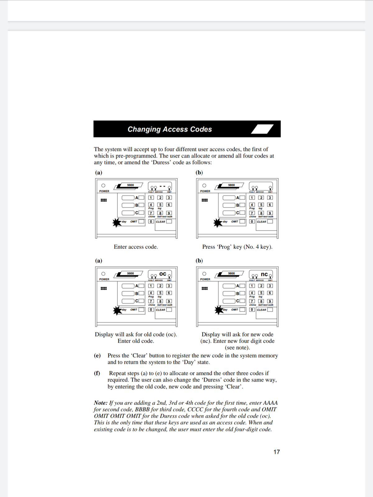

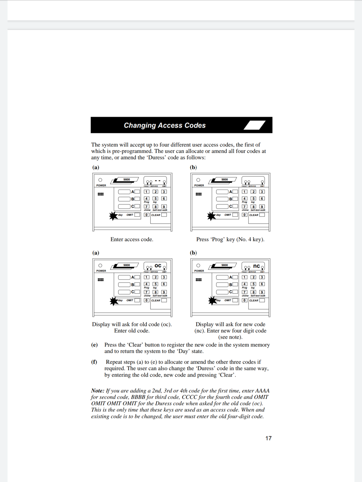

one of the buttons on my keypad has become so worn that it will not press in any more so I need to change the access code. Can anyone give me a step by step guide as to how to do this please?
Very slowly press each button firmly when following these instructions and you should be ok.
Use numbers that you have not used before for new code
