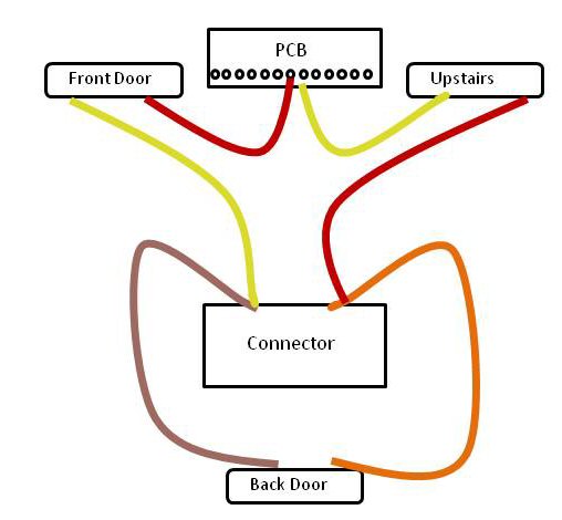

Do they go back to the control panel on separate cables ? ….if so measure the resistance of each one ….post picture of all panic buttons
Thanks for your speedy message sparky. I am on the road until Saturday but will investigate the cables and take pictures as soon as I am home.

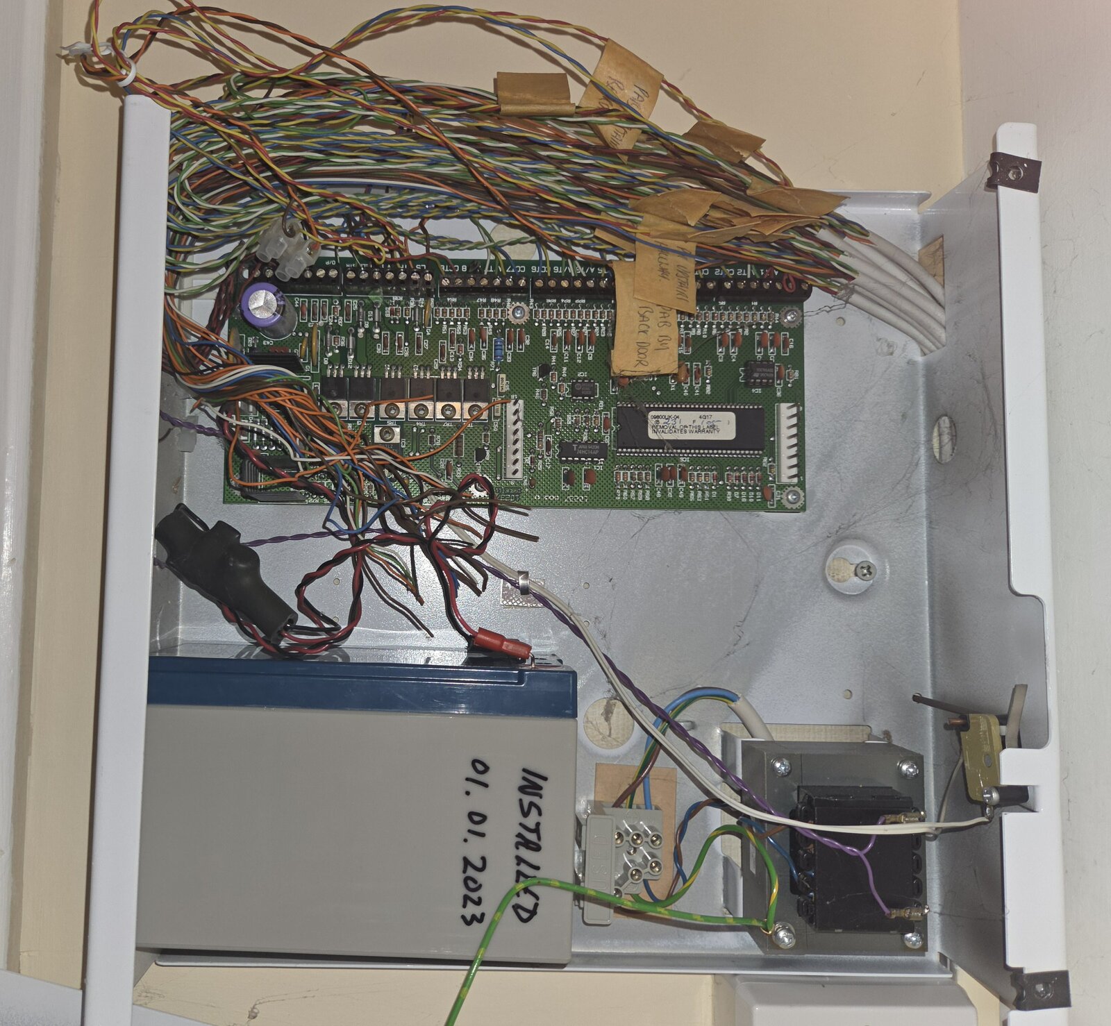

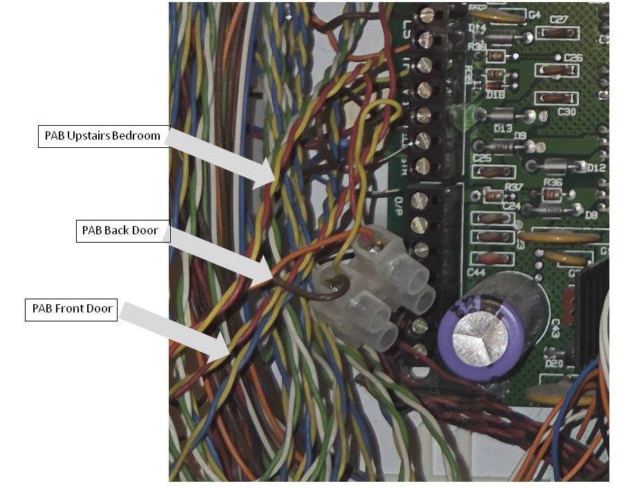

They go back to the control panel on separate cables but within the control panel is a connector that effectively links them together. The attached 3 images show this in detail. Can you advise on how to check resistances. Meanwhile, I don't think we've ever used/needed these Panic Alarms so might it be easier for me to just disconnect inside the contol panel?

Remove one leg from the zone then measure each pair with a multimeter set on ohms ….if one pair is very high that’s possibly where the issue is

Remove the red connected to the pcb .. you will now have 3 pairs of wire ….starting at the red you disconnected and the connector block measure this , now measure at the two connector blocks , and finally the last connector block and the yellow still in the pcb
On a average cable run ( depending on quality of cable ) you a should be looking at 1- 3 ohms on each pair
One (last?) question do I need to disconnect a battery terminal before I remove the red from the pcb?
Well, I've measured the resistances and the red (that I removed from the pcb) to the connector block is 16 while the other two readings are 3. So would I be right in thinking it's the Panic Alarm at the front door that's causing the problem?
If so that's the one that we are never likely to use so I'd like to just take it out of the system.

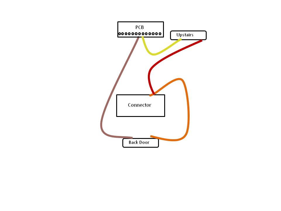

Could I achieve that by simply removing the yellow for that PA from the connector and taking the brown from the back door out of the connector and into the pcb (where the red was)? That would now look like the attached picture.
