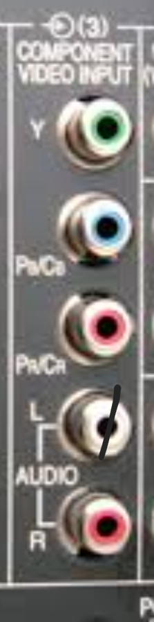

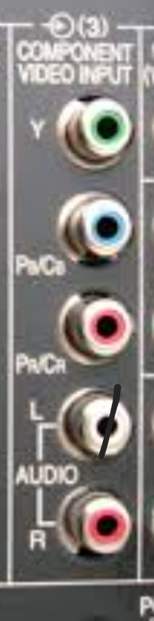

It may be that the TV doesn't have a SCART connector, but it could have RGB RCA sockets on the back - something like:
If this is the case a simple SCART to RGB RCA + audio lead will do.

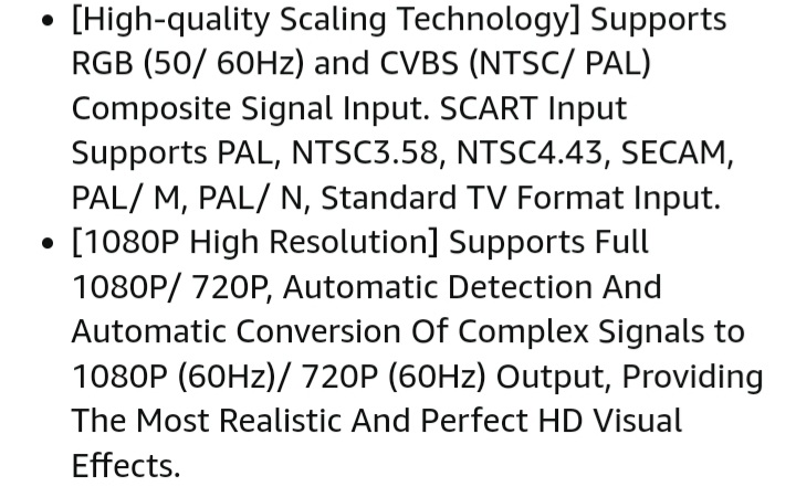

Useful knowledge. What's the SCART to HDMI convertor you're using, and is it still made? It might help the OP.
The one I have is unavailable, but the one in the link:
If not, SCART to HDMI converters are available, such as:
https://www.amazon.co.uk/LiNKFOR-Converter-Adapter-Supports-Headphone-Scart-HDMI/dp/B078JJMR5J
(Cheaper alternatives are available!)
Has exactly the same case and port layout, so I'm relatively confident it has similar internals! :)
And from the description, it states support for RGB:
