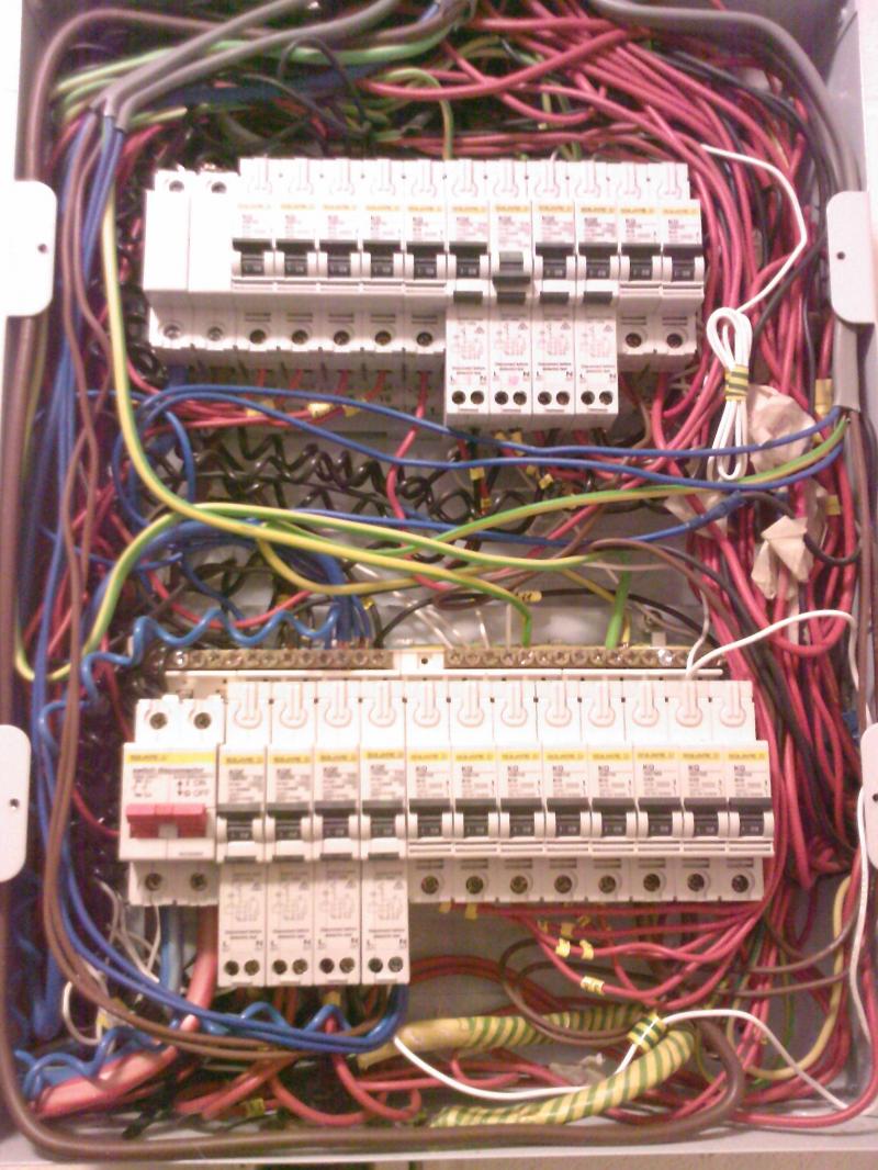

I wish I had a decent camera phone to take pics of some of the $h1te that my predecessor did where I work now.
Remember this one :-
Rats nest, no labelling, no testing and at least one circuit with a borrowed Neutral
That's tasty.
