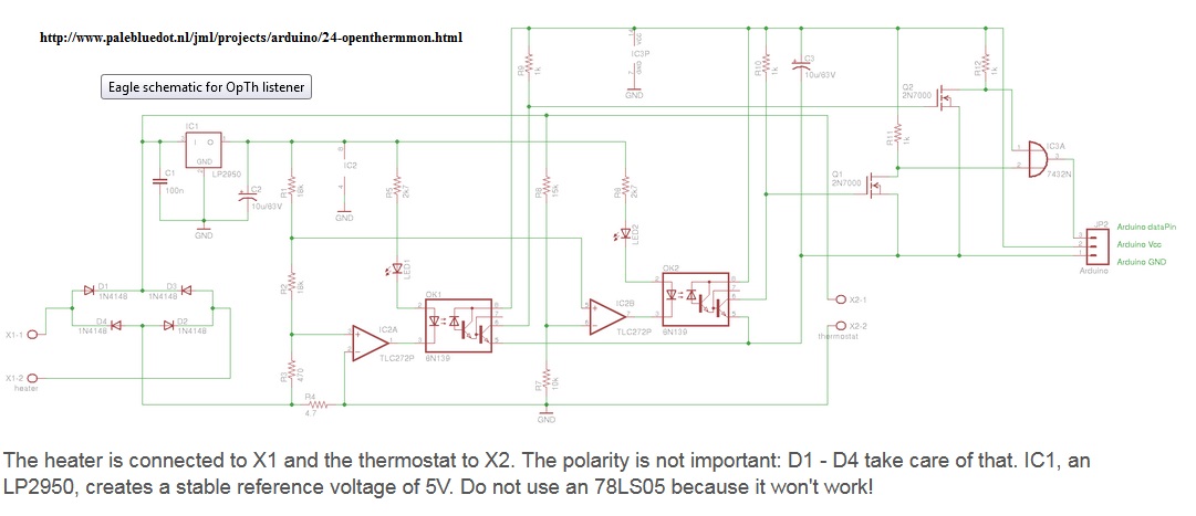

A good description of the OpenTherm communication system is to be found by clicking on here
This section is relevent to the discussion about interference. The original method ( before it was adopted by OpenTherm) was polarity critical but OpenTherm has modified it to make polarity non critical by adding bridge rectifier at the cable interface.
The only advantage ( unless someone knows better ) is that wiring errors by careless installers will not prevent the system working ( or damage components ).
The major dis-advantage is that the diode bridge will significantly decrease the receiver's tolerance of interference. Decoupling capacitors across the diodes would restore some of that lost immunity to interference.
just to recap this was about a clever ( if there was one) way to neaten up screened earth terminals.
The answer is to use the correct glands for the cable, whether that is CY or any other type.
However there is absolutely no point in using screened cables if all of the connections are in plastic boxes.
Given the very low data rate of OpenTherm (1000 bits/second), there should be no need for screened cables anyway.
