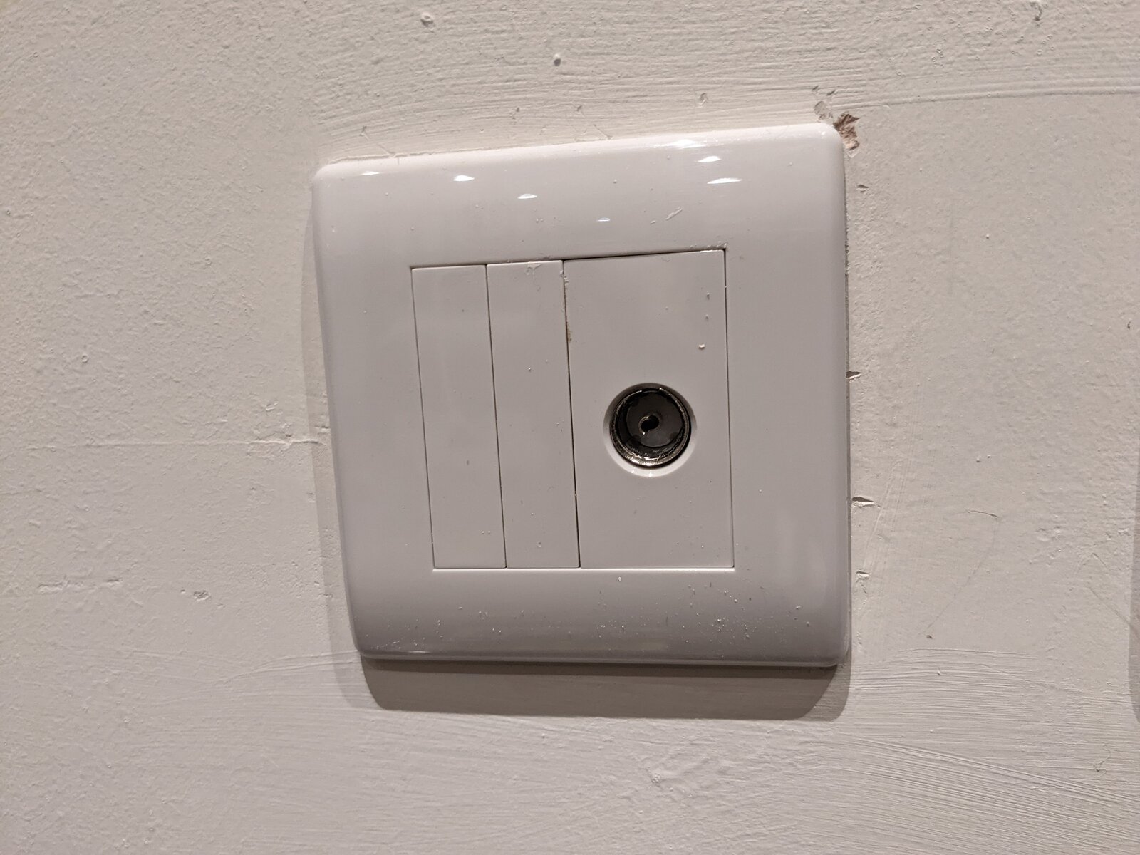

Screwless wall coaxial TV socket
31 Aug 2021
10
The female pin got broken. No clue how to open the faceplate which has no screws or notch on the bottom edge. No make visible. Any help will be much appreciated.
Looks very similar to this https://www.screwfix.com/p/lap-2-module-modular-faceplate-white/42092
The cover plate will come off but only with the module/blanks out I suspect?
Current convention is for UHF TV aerial wall plates to use male plugs (then female to male lead used to receiver). But old habits die hard.
The Toolstation module above is a screened outlet which is good. Ideal, in fact.
you could use one of these instead of a coax outlet.
(and it's even cheaper to make your own!!. Blank plate, f joiner and drill!)
Yes, nice idea.
It may confuse a few into thinking they have a satellite feed though ;)
A right angled f plug on the inside, may also be needed (depending on the depth of the back box), to avoid too tight a radius on the cable.

Thanks Sureitsoff, good idea.
The link contains the picture of the narrow blanking plate which also I was looking for. Much grateful!

I always use a right angle plug on the outside ie room side so that the cable goes parallel to the wall as well, much neater
