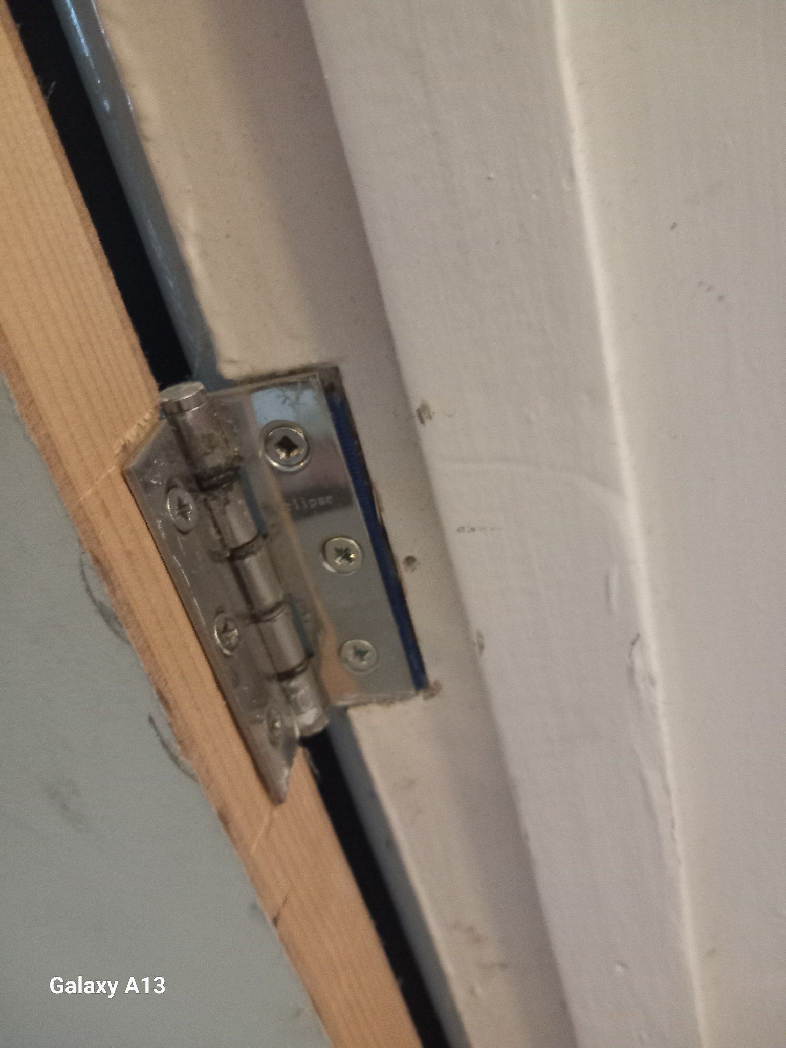

Two of my internal doors the latch side rubbing so rather than planing that side it's better to tighten the hinge screws I believe but they're not biting hard into the lining. Take screws out and put in bits of wood and wood glue then screw back in straight away?

Yes but wait until its dry, I use the round bamboo skewers, its like they are bade for the job, if the point end is really long then nip it a bit shorter with the wire cutters section on a pair of pliers and also cut it down to about 2 inches uou can then coat with glue and hammer it in as they are very strong that way, then just snap them off level when dry. Drill a pilot hole and use hinge tight screws.

I use matches with super glue to plug the hole.
Larger holes, perhaps wooden dowels with wood glue- longer wait drying time.
Out of interest, why are the hinges not rebated into the door edge?
Think I packed them out for some reason, must have been binding somewhere
