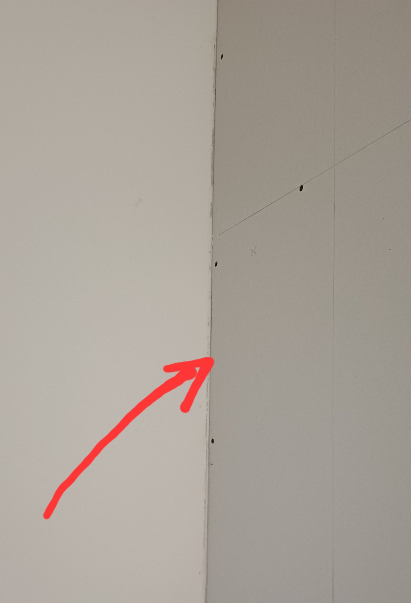

I've just finished sheeting a stud frame partition and I'm about to cover the joins with scrim tape. My question is, do I apply it to the joins where the partition meets the existing wall and ceiling?
Short answer is yes.
Corner tape going around the corner.
I mostly didn't though.
I made sure there was no movement.
I would use a polymer grab like CT1 along joint then put a tape down tight to wall Vs going around the corner.
The tape just covered the gap and filler
The specific area I mean is where the new plasterboard meets the existing wall, as in the photo.
What's the construction of the existing wall? Are you going to redecorate both?
I have taped corners like that (and ceiling joins). Same as corner in new plasterboard; apply compound, bed paper tape into compound, more compound over etc.

I'm not doing the plastering. I'm rubbish at it. I've built the partition and sheeted it. I'll tape it ready for someone to skim it.

Where the new PB joins the exiting wall, are you gonna run a grinder down the existing wall to match the heights either side of the join?

Not sure what you mean by matching heights. The new pb runs from floor to ceiling.
