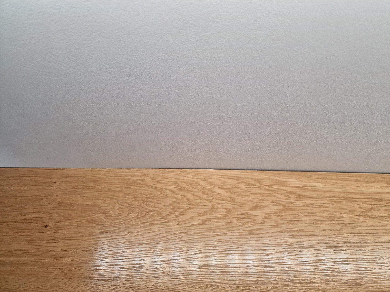

The joiner I hired to do my home office left the job unfinished, resulting in
a lot of snagging, one of which is a gap about 1-2mm behind the worktop.
The gap is uneven since the cut was uneven, due to a bent static wall.
Should I do anything with it like seal it with silicone or caulk? Or leave it like this? It's not the end o the world but I could see the odd post it vanishing behind it.
You could fit a wooden bead along it. Or, clear silicon?
1 to 2mm is acceptable IMHO. You should always seal worksurface to wall joints in a "community" environment - so a bead of clear silicone is all that is needed
Even if you put in an upstand there is likely to be a gap between the back of the upstand and the plasterwork, a least in places, which will need to be caulked or siliconed - and for hygeine you'll still need a bead of silicone at the junction of the worktop and the upstand... Just in case you knock a coffee over...

I am a decorator....
You can use silicone but when it comes to repainting the wall, you won't be able to paint over the silicone.
For a 2mm gap, I would recommend an acrylic sealant that matches the colour of the wood.
Eg https://www.solmer.co.uk/hardware/unika-colorsealant-310ml.html
Use low tack tape on the wall and run the sealant, smooth off with a damp J-cloth. It will shrink back slightly. If you are unhappy with the shrinkage, repeat the process.

That's true. Imma go for that.
