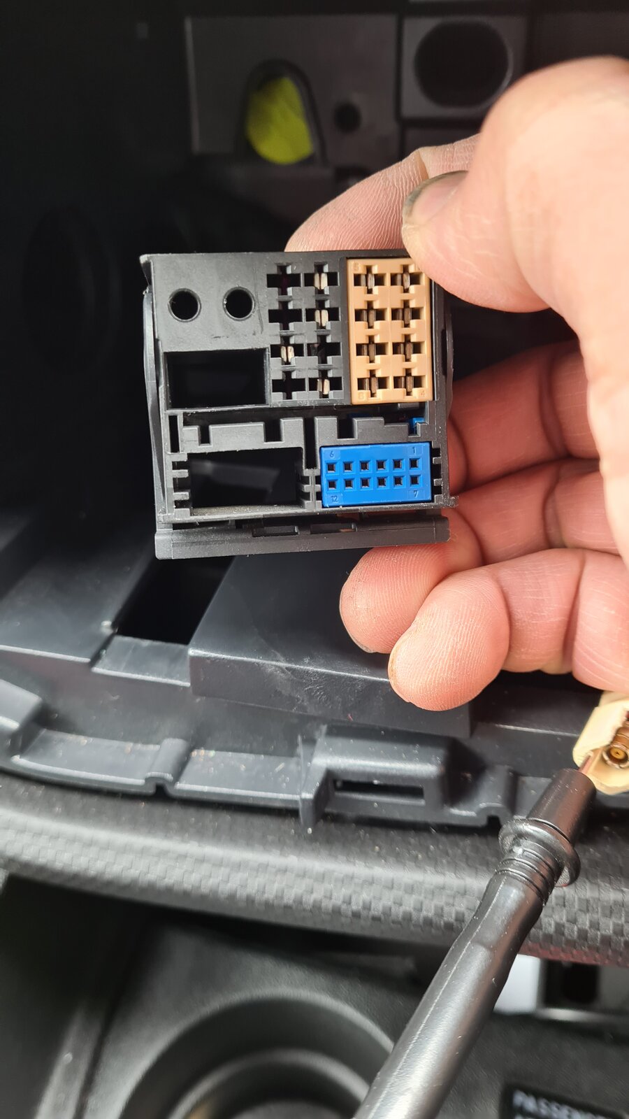

Seat Leon. Battery flat.
I wonder if the permanent live might have been swapped over with the ignition on live wire, maybe somewhere in the loom?
That would account for the discharge.
I doubt it as its factory fitted unit...perhaps a bad esrth?..I've got a multimeter, there should only be one permanent live wire in the connector as I read somewhere, to keep memory or clock or something..every other wire should be 0. Unless ignition is on..
See if you can find a pin out for the plug, so you can check it properly - there will be one online somewhere. Yes, there is usually a permanently live 12v, to retain station memories, clocks and other settings in the radio. I doubt a poor earth would cause it.
Here's the plug connector
