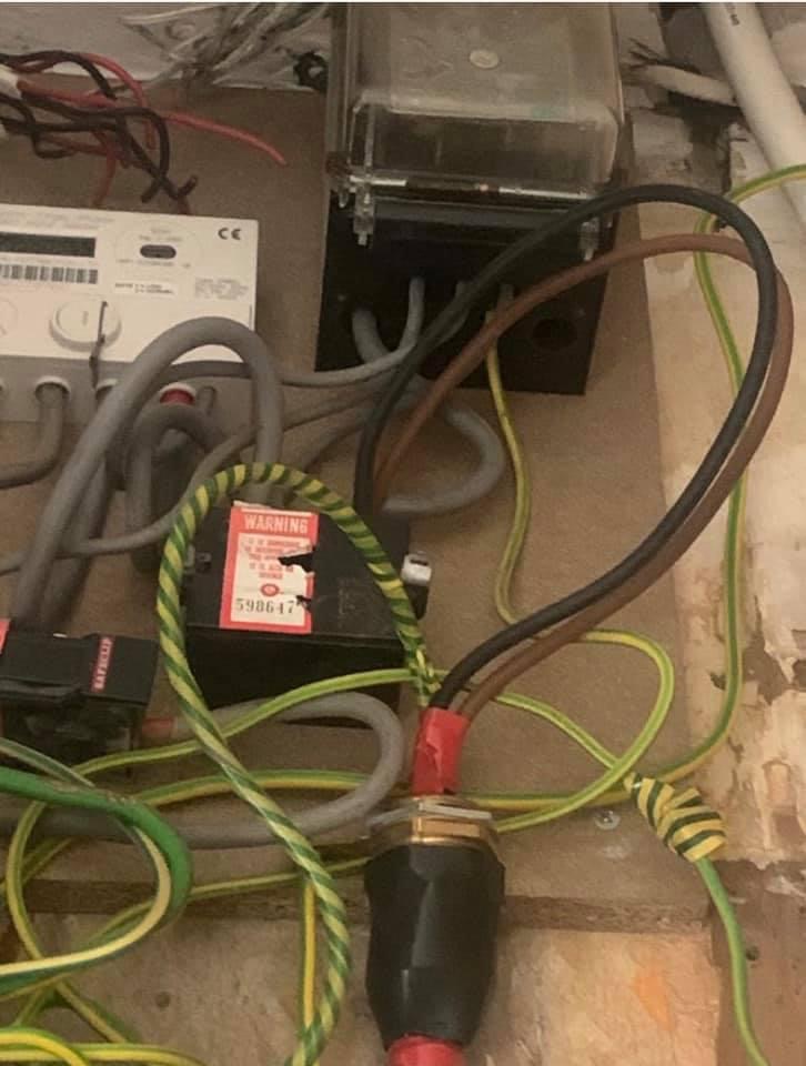

But the legs from the CU to the first floor also need to be replaced - or are you suggesting I use the existing red/black wires from the CU (slieved as blue/brown) to the first floor and then use blue/brown from there for the rest of the loop?
Don't know if this helps?
I have two consumer units, connected via 16mm SWA (3 core) around 16M, on the main CU it's protected by a C50 fuse.

Without reading all the way through I'd say your options here could be 16mm SWA from the Henley to the new board running no more than 63A.
Or work out the max demand for the loft and do a calc to work out cable size and come off a new breaker in the existing board. Say 10mm SWA of a 50A breaker if it checks out ok.

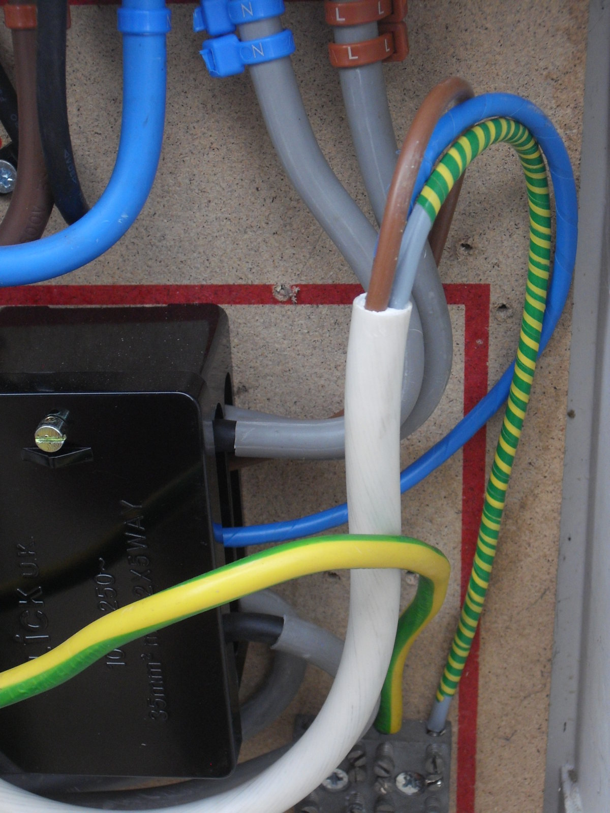

How do you connect no doubt more than 3m of 16mm2 SWA to a Henley block?
Like that (y)
