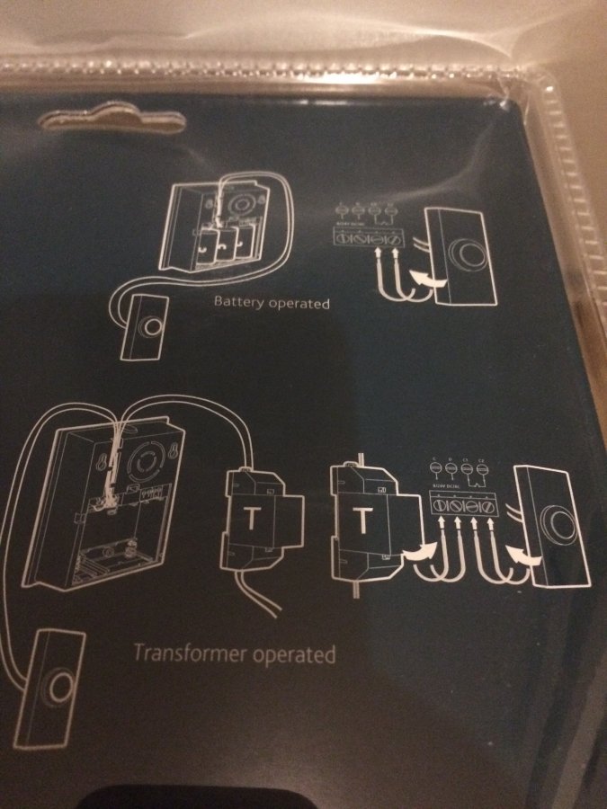

ok thanks, what i may do is borrow my dads chime and see if that works as a 2nd chime on mine. then i will know if i need a new transformer as well as a new chime.
I borrowed my friends chime (no mechanical ding dong) and that doesnt work so will try a ding dong like the one i have already.
Here are the pictures...

You would need an electromechanical chime. That electronic one won't be compatible with very much without connecting it to a permanent supply from the transformer and then feeding the push terminals via the contacts of a relay operated from the other chime!
Matching chimes and a button is best, keep it simple! That and 2 different models working together will sound awful.
when you
at a guess, id say it not working, was possibly due to it being connected wrong, how did you connect :?:
connected the 2 terminals on my current door bell to the 2 right hand terminals. when i pressed, the current doorbell worked but not the new one.
That wouldnt work as freddie says above.
Your mates one needs permanent power to the left two terminals and its OWN bell push connected across the right two terminals, you could fool your mates bell by linking the two right terminals, so when the buttons pressed the first bell will DING once, the second bell will do whatever, till you release the button and then your ffirst bell will DONG once, not ideal really.
Ah ok, so bridge the right 2 terminals on the new and then connect the 1st 2 terminals to the original chime terminals?
yes, on the new one left 2 terminals, connect to the left 2 terminals on the old one, anyway round
