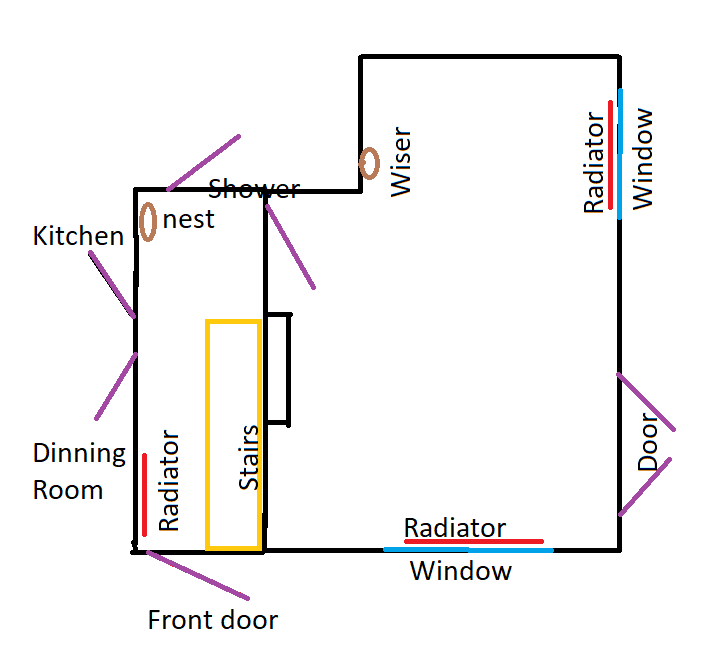

I can't see a problem, I have done it before, but with a gas boiler, now using oil. But just in case something I have not considered, asking the question.
The main problem is the cats, who will claw at the carpet if a door is closed, so we have a door stop to stop the raising butt hinges fully closing the living room door, the hall radiator is near front door, with a programmable TRV head, and the wall thermostat other end of hall, about as central to whole house as one can get, two doors between it and the radiator, hard wired, but the distance means it can over shoot.
Setting at 0.5°C raise every two hours has before doors stopped from closing fully worked, I do not like wireless, already had problems with previous house where the thermostat and base lost contact with each other, but should not really be a problem if using two thermostats, as if one fails other will still work.
So tomorrow fitting a wireless Wiser thermostat in parallel with the Nest Gen 3 wired thermostat, putting the Wiser head in the living room, to keep heating running if living rooms cools faster than the hall. Approx shape of living room and hall 1728239576611.png showing radiators and doors, plus stairs and windows. The boiler is in the flat under main house, only two wires between boiler and main house, which power and take signals from the Nest Gen 3. This also controls DHW if required when CH not running, but C Plan so can't turn DHW off, and now use solar in summer for DHW, so second thermostat for CH only.

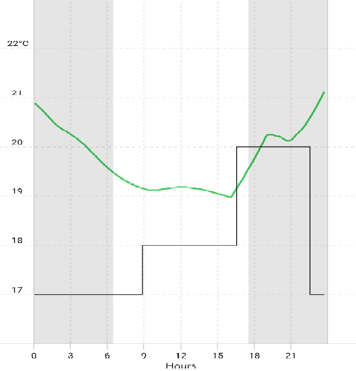

Now day 3 so not really had a chance to really test it, however clearly have a problem with over shoot. 1728553932537.png but the TRV report 1728554152979.png does not match the free standing thermostat report, it is complicated by having two radiators in the same room, so two TRV's one Energenie Mihome the other Kasa the latter gives the report, and I need to now experiment with the settings and the placement of the free standing thermostat.
