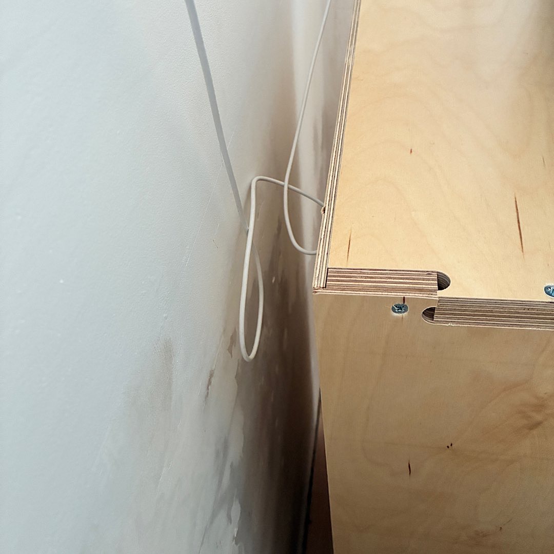

Hi all,
I'd welcome some pointers/advice. I need to fit some plywood kitchen base cabinets, and secure to a solid wall. The cabinets themselves are flat backed and it has been designed that there is a 67mm void behind to accommodate services etc. I've attached a photo if that helps showing the back of one of the cabinets, with roughly the sort of void that I'm looking at.
I was thinking of securing a timber batten 'rail' to the solid wall at the same height as I want the cabinets more or less: something like this:
https://www.wickes.co.uk/Wickes-Studwork-CLS-Timber---38-x-63-x-2400mm/p/107177
Then using angle brackets such as these, attached to the rail and then in turn secured to the top of the cabinet:
https://www.screwfix.com/p/essentia...ckets-silver-60mm-x-60mm-x-20mm-10-pack/930ta
The worktop is wood so I can recess a bit out of the reverse side where these brackets are, so it still sits flush on the top of the cabinets.
Is this the best approach? I appreciate I can do without the batten on the wall and get longer angle brackets but I thought this might be easier this way once I have this up (so I can just use timber screws to secure them all) and perhaps a bit more secure.

That is so helpful. I was doing some googling thinking there must be some form of universal fixing for this scenario but couldn’t find anything. That looks much easier, and better.
Thanks!
No problem...
You could use a washer on the inside of the cabinet to help stop the screw going in too far... (y)
