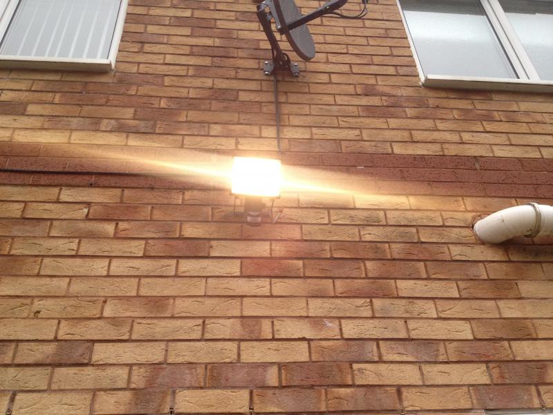

Security light not working after dining room light fitting
Its always been this way since the hosue was built back in 2001, unless the previous owners did some changes
Are the dinning room lights (or any others) double switched? Ie, can be turned on/off by one than one switch?
To the best of your knowlage, is the outside light origanal? Matching switches, etc?

Hi Daniel no double switches etc, the issue seems to be the way the new light fitting has been wired up. So going to be looking at that.

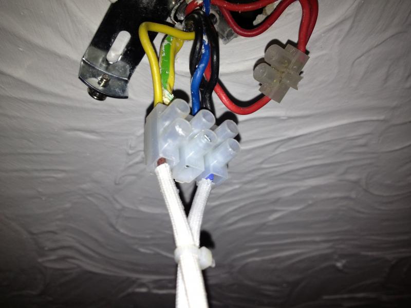

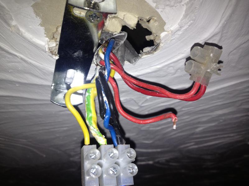

Reason i didnt do it myself was because when I opened the rose it looked a bit out my depth. A friend stepped in to help, and looks like its gone a miss since then.
Presumably yellow for the switch wire if a 3 core and earth has been used to provide L, sw L and N at another point in the circuit.
Have, with the power off, you checked all the connections are sound, including the bunch of reds?
I found the culprit! A loose red! Thanks to you all for your help and input especially Belfast!! Now all I need to do is mess about with the Pir settings so its not on in daylight when switched haha.

Some PIRs lights, if switched on and off quickly at a control switch, go into manual mode.
Find the instructions for the lamp PIR. It may save you hours of fun running up and down a step ladder.
Unless of course, your idea of fun is running up and down a step ladder. :D
Thanks for that info will dig out its instructions although wouldn't do me any harm being up n down a ladder umpteen times haha
