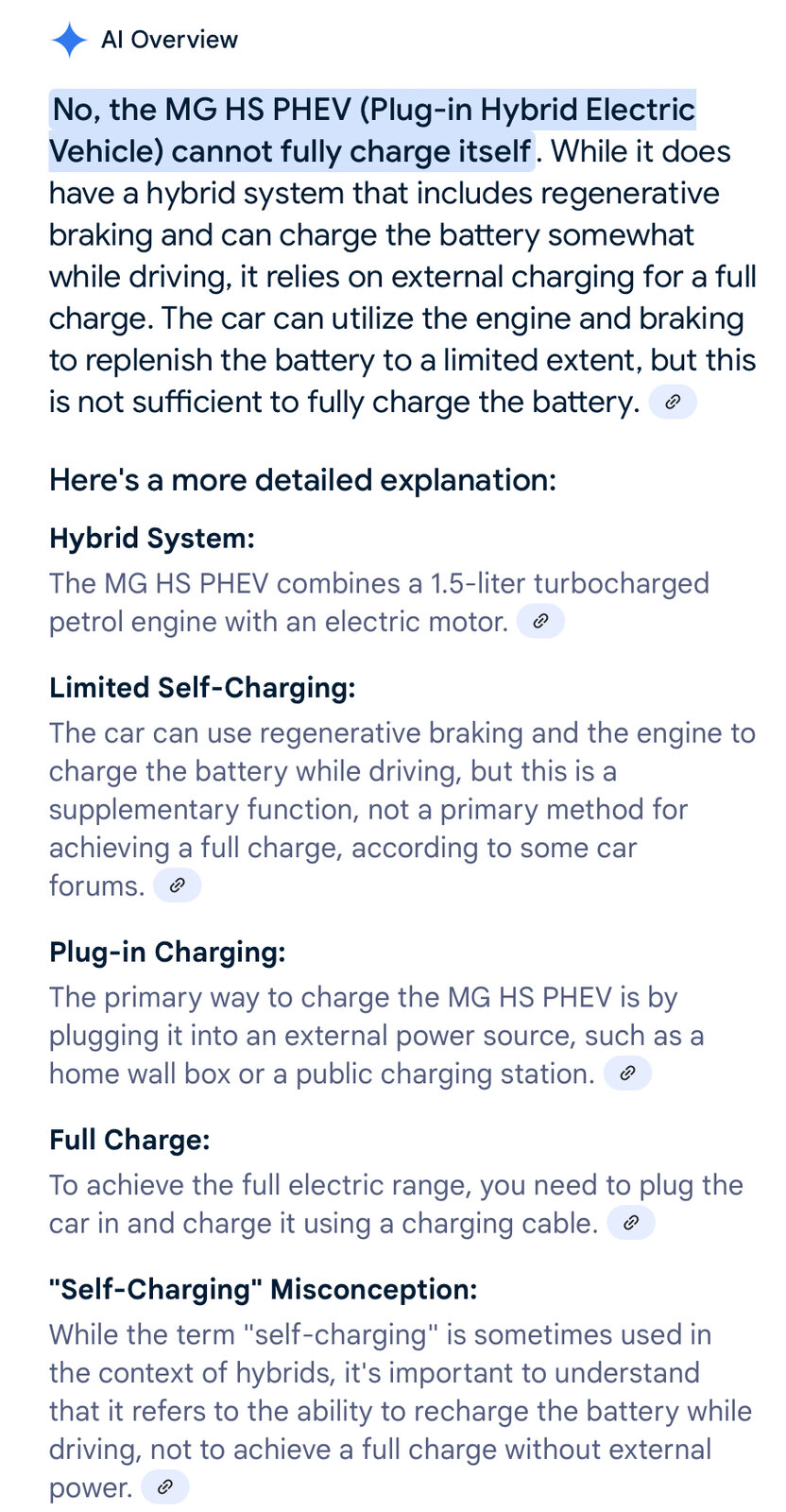

Apparently,the MG HS PHEV can recharge itself once discharged.
Most PHEV's can recharge themselves to a certain degree but most of them can't fully recharge to a full battery unless they are plugged in to the mains. Those that can self charge themselves fully, cost an absolute fortune in fuel using the ICE to charge the battery, much more than if charging it with cheap rate electricity so pretty pointless really.
