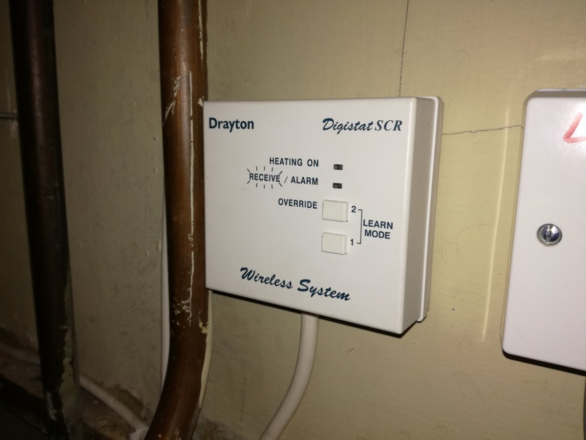

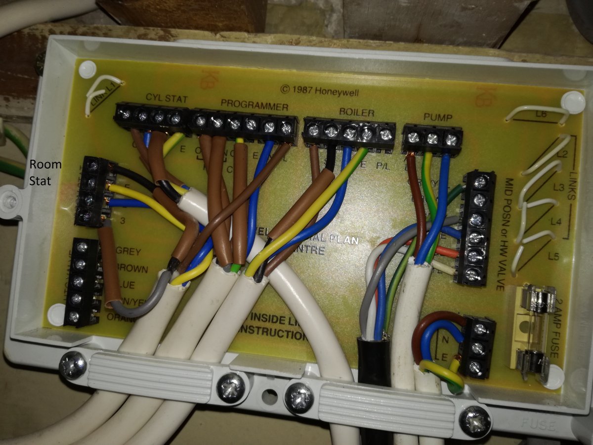

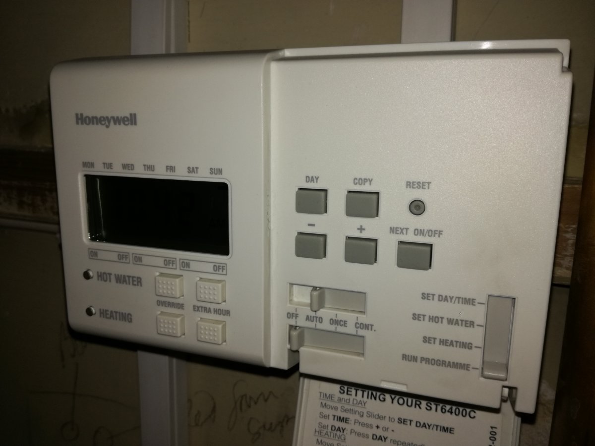

The current set up is a Drayton Digistat for room temperature and a wired stat to the hot water cylinder. There is also a Honeywell ST6400C programmer. These in turn are connected to a Honeywell Circuit board. Pictures attached.
I originally assumed the Hive simply replaced the Digistat, but now I guess the programmer needs disconnecting and the wires from the hot water cylinder stat need to make their way to the Hive??
The set up is a Y plan, on a condensing boiler, the pump for which is connected to the boiler and not directly connected to the circuit board.
The Hive replaces the programmer.
The Digistat is removed and a wire link installed in the wiring box.
All of the wires required for the Hive should be located behind the programmer.

Thanks for your reply, first chance I've had to look.
What do you mean when you say a wire link is installed in the wiring box? Currently the circuit box (wiring box?) in picture 3 has the wires for the room stat (9 o'clock in the picture) and these run to the digistat in picture 1. If the digistat is disconnected where would these wires then go?
Again, apologies if I'm being daft!!
Wires to the thermostat are disconnected from the wiring box and removed, as they are not required.
A link is then installed between two of the terminals in the box, this is the equivalent of having the thermostat set to on permanently. Probably terminals 1&3 although this must be checked first.
All of the switching is done by the Hive box which uses the same wiring as the programmer.
