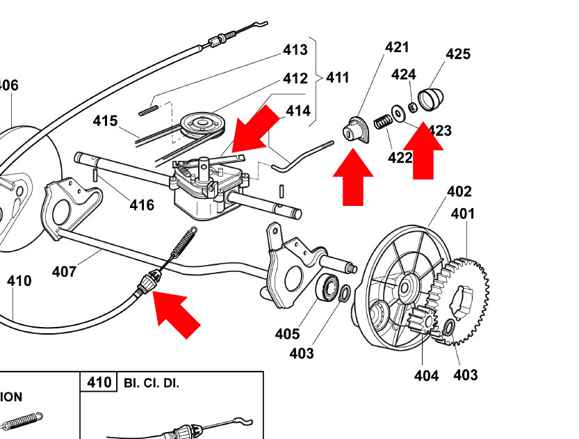

I present I don’t see the connection of the gearbox end BUT my concern is the fitting.

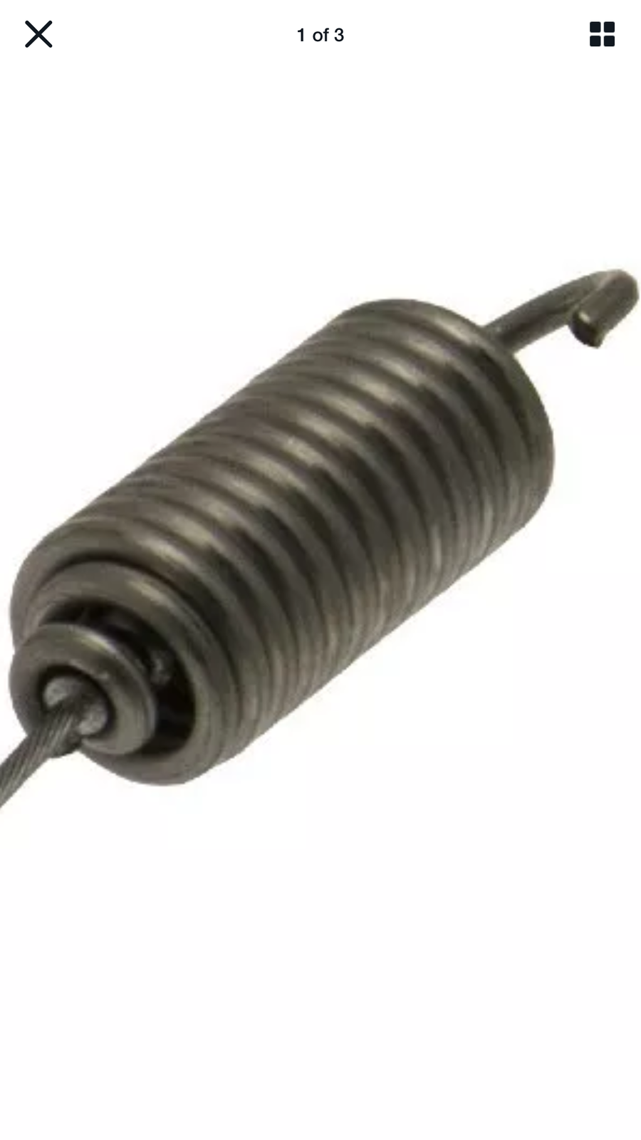

Quickly looking on eBay I see cables with springs ?
Is this likely to have fallen off when it snapped thus being on the customers lawn ?
If not is the cable just wound around a coil thus the nipple part now being trapped inside to then use the spring as a return ?

Your picture shows the common arrangement for the cable connection to the gearbox, this gives a gentle engagement of the gearbox dogs and a return spring assistance at the same time - although the gearbox lever does have its own small spring. The cable nipple slides within the coil spring and adjustment is either at the handlebar end or on the cable itself. Always best to use the makers cable, I find!

Ive felt in the back of the gearbox a lever which has a cut out in it so looks like the spring hooks over it.
Some other cables for the same mower have nipples but the set up I’ve got won’t accept them.
So it seems the cable I show with the spring on the end is the one I need.
Cable adjustment is up by the throttle lever.
Yes, that's the one. There will also be a clip or some sort of locator on the gearbox to hold the cable outer......here's hoping its still there!

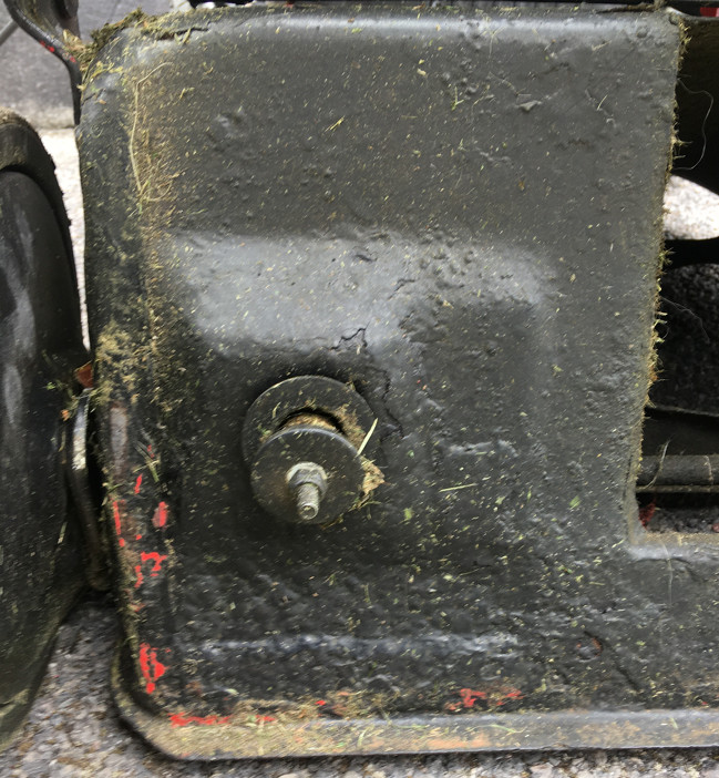

I cant quite see let alone get my hand i there to unclip the cable ready for when the new one arrives.
Please see attached photo,it feels this is connected to the gearbox which at present only rotates a bit.
I need better access to the gearbox to unclip the cable.
I dont see another plastic cover etc other than the drive belt cover ive removed so if i undo this nut that is shown in the photo will it allow the gearbox to rotate more given me better access to unclip the bacle.
Champion R484SP
That's the gearbox tensioner - or rather it keeps the drive belt in tension.
I would imagine there would be access under the deck via some sort of plastic cover, but you may have to take the blade off to remove it......only tip the machine back on its handles, not the side.
If all else fails and you just can't see, I find the best thing to do is to drain off the fuel and oil,and invert the machine completely which is a monumental bore.
John :)
