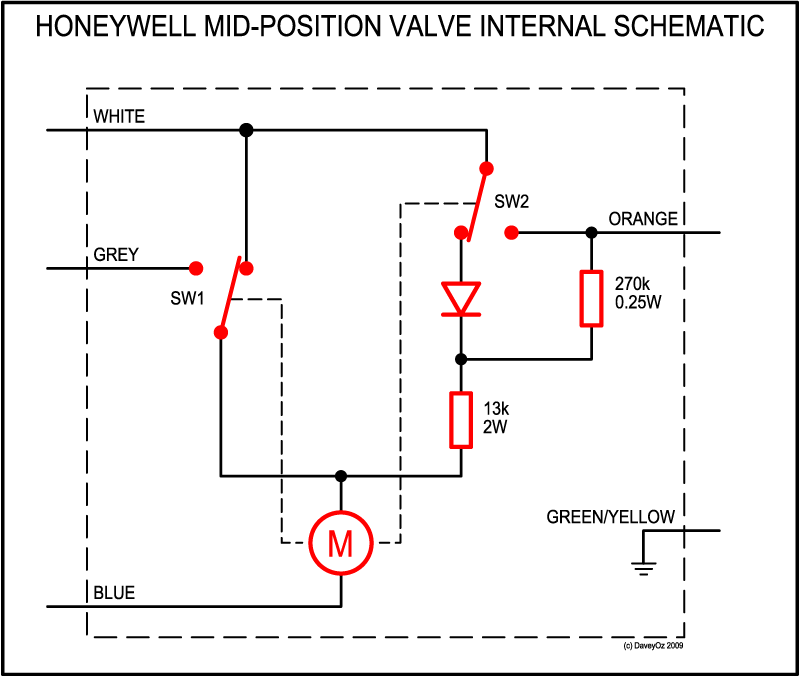

Here is a schematic of a 3 port valve (albeit a Honeywell), in its rest position...
If 230V was applied to the Orange wire, there would be an extremely small current draw from the motor windings, and the two resistors in series - I estimate this to be <1 mA.

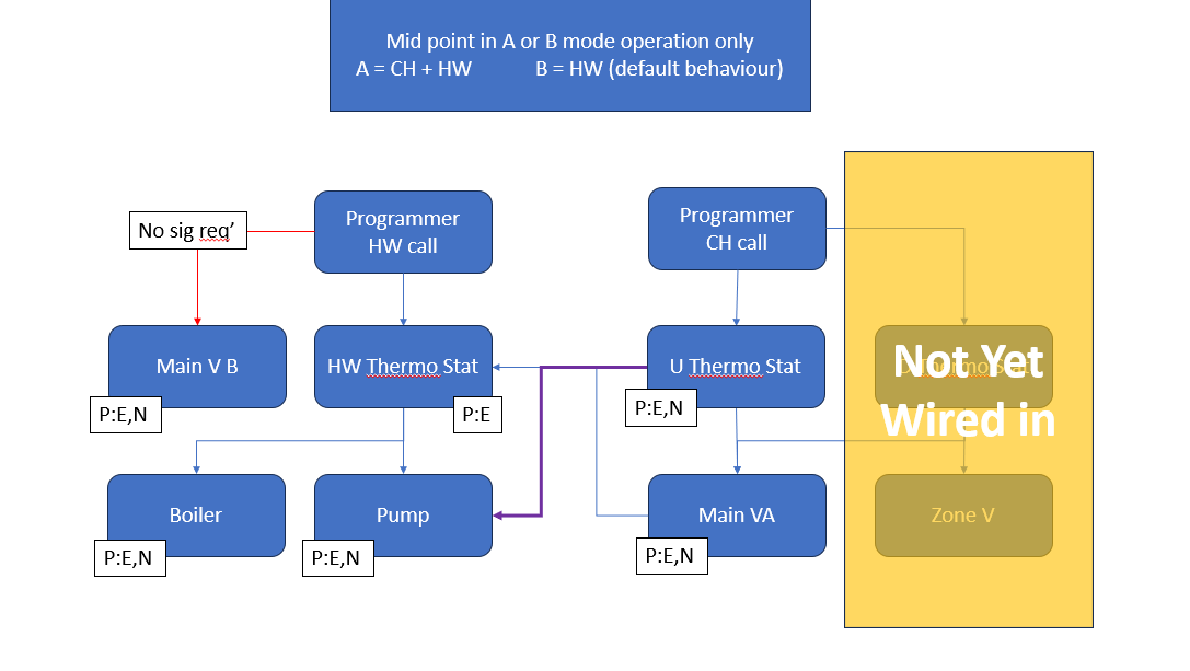

I think it may be clearer if I provide context. This is my post where I explain my setup and what I'm trying to achieve https://www.diynot.com/diy/threads/room-thermostat-to-call-pump-only.641074/
I've set up my wiring to achieve this process flow:
I want to be able to control the max temp of the water in the system so boiler control can only be managed through the HW thermo. In CH call mode the default behaviour is to pull stored heat from the system via the pump and the boiler will only activate when the HW cylinder temp drops. Problem is, I'm worried that in HW only mode, the common HW thermostat terminal will cause the load to also travel back up the orange wire (in a reverse circuit) and I don't want to damage the valve.
Current flow in resistors will split after the diode as that switch is not made for HW call ( comes into circuit during heating only)
To motor to hold it in place
To call wire on appliance, the flow will, as you said, be very little
