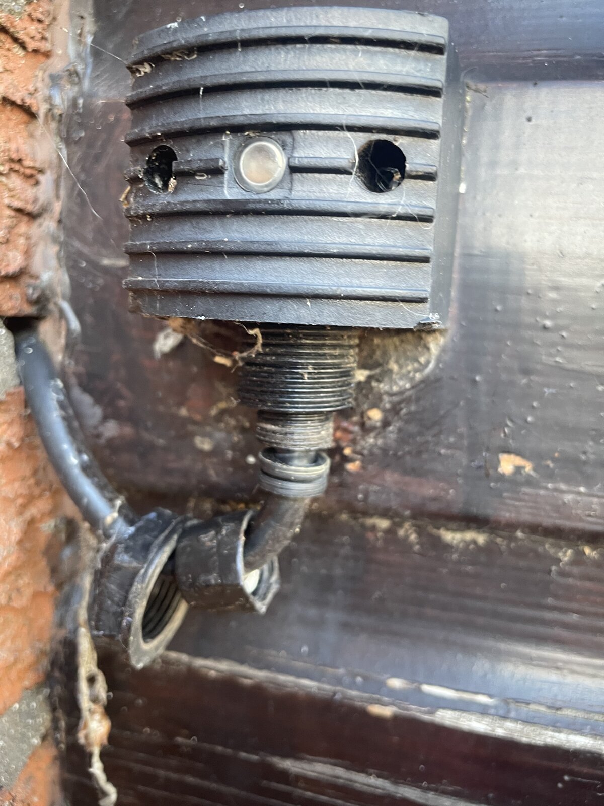

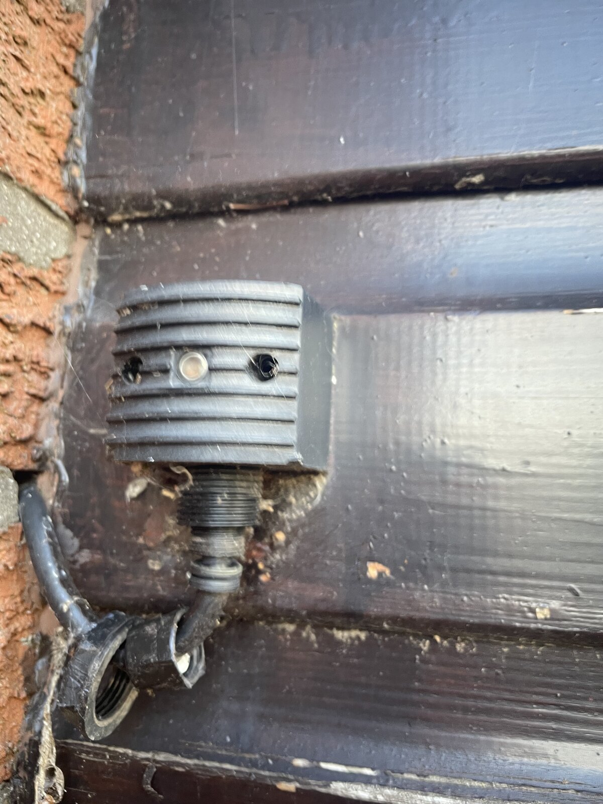

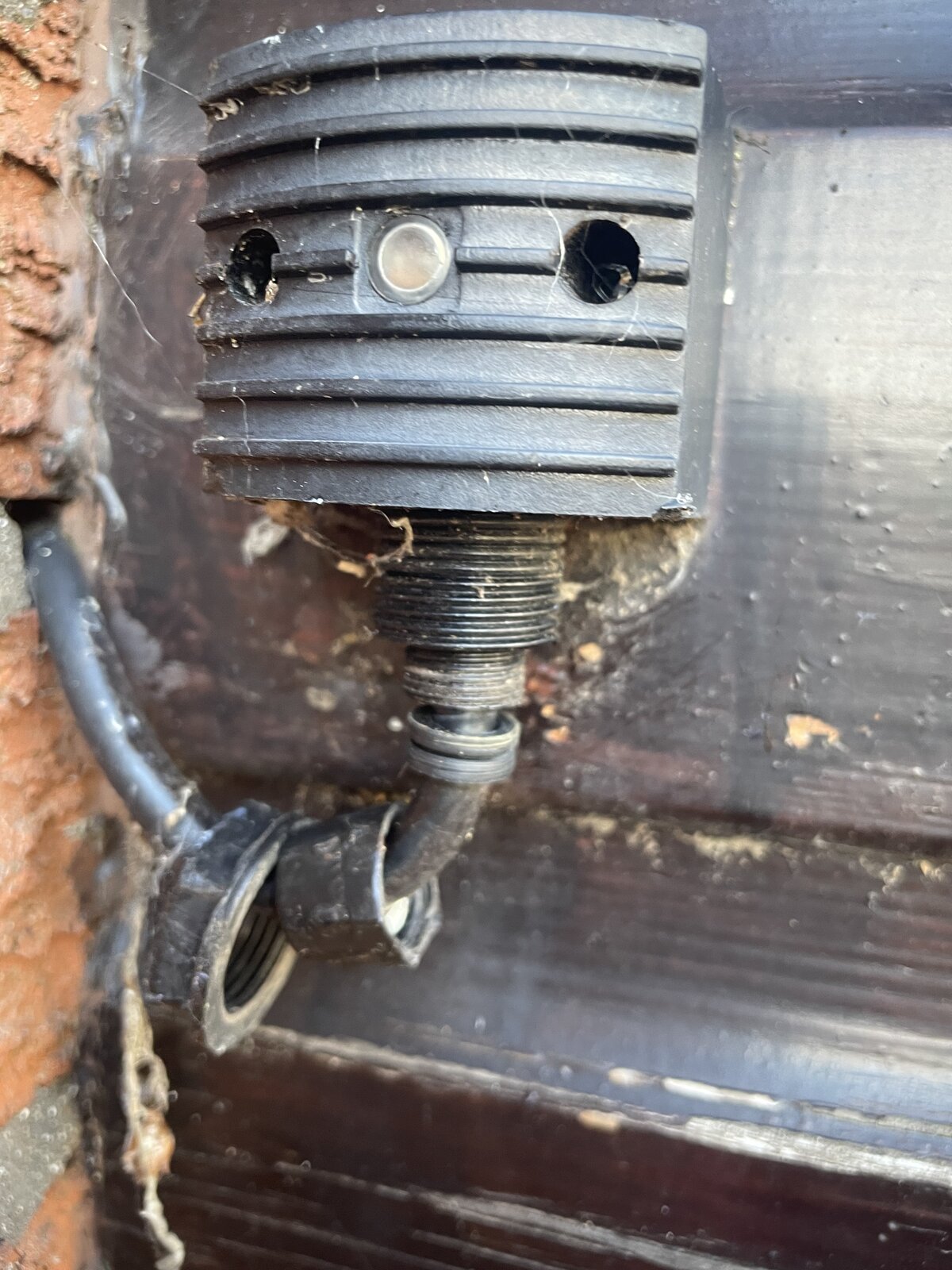

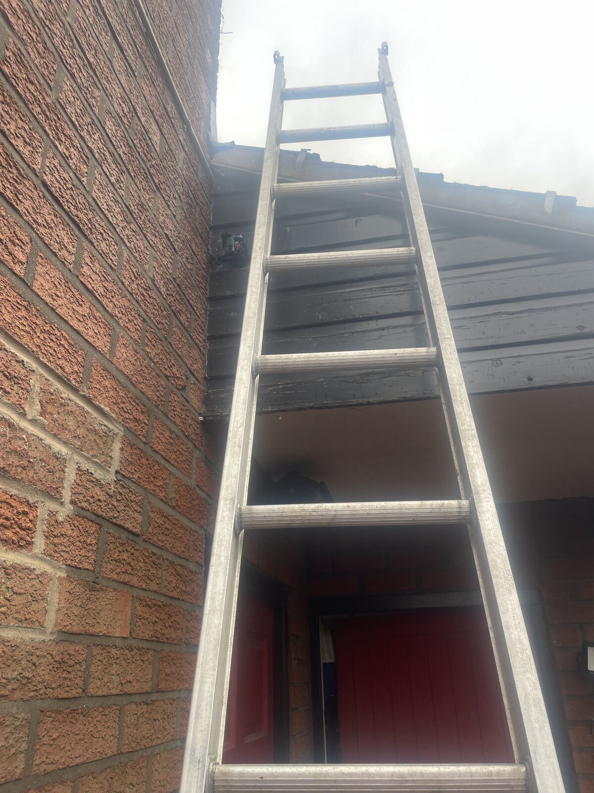

Any help with this and what it might do.
Thanks.

It is a photocell. It is usually used to turn lights on when it gets dark, and on again when it gets light again.

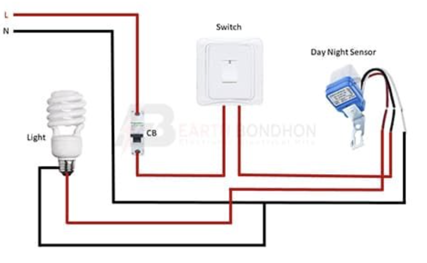

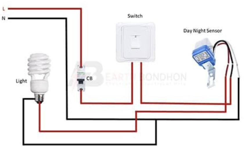

Possibly wired like this

Thanks. Do these fail. I don’t know where this is linked to.
Presumably I can bypass it. ??
Yes they do fail. Cheap and easy to replace. If you bypass it then whatever it controls will be on all of the time.
That looks like quite an old one.
Probably outside lights
You'd need to check if its even still connected. If i was doing it, I would find out where the cable goes to and then use a test meter.
Or you could temporarily bypass it and see what stays switched on...

Ok will try that
Thanks for your advice.

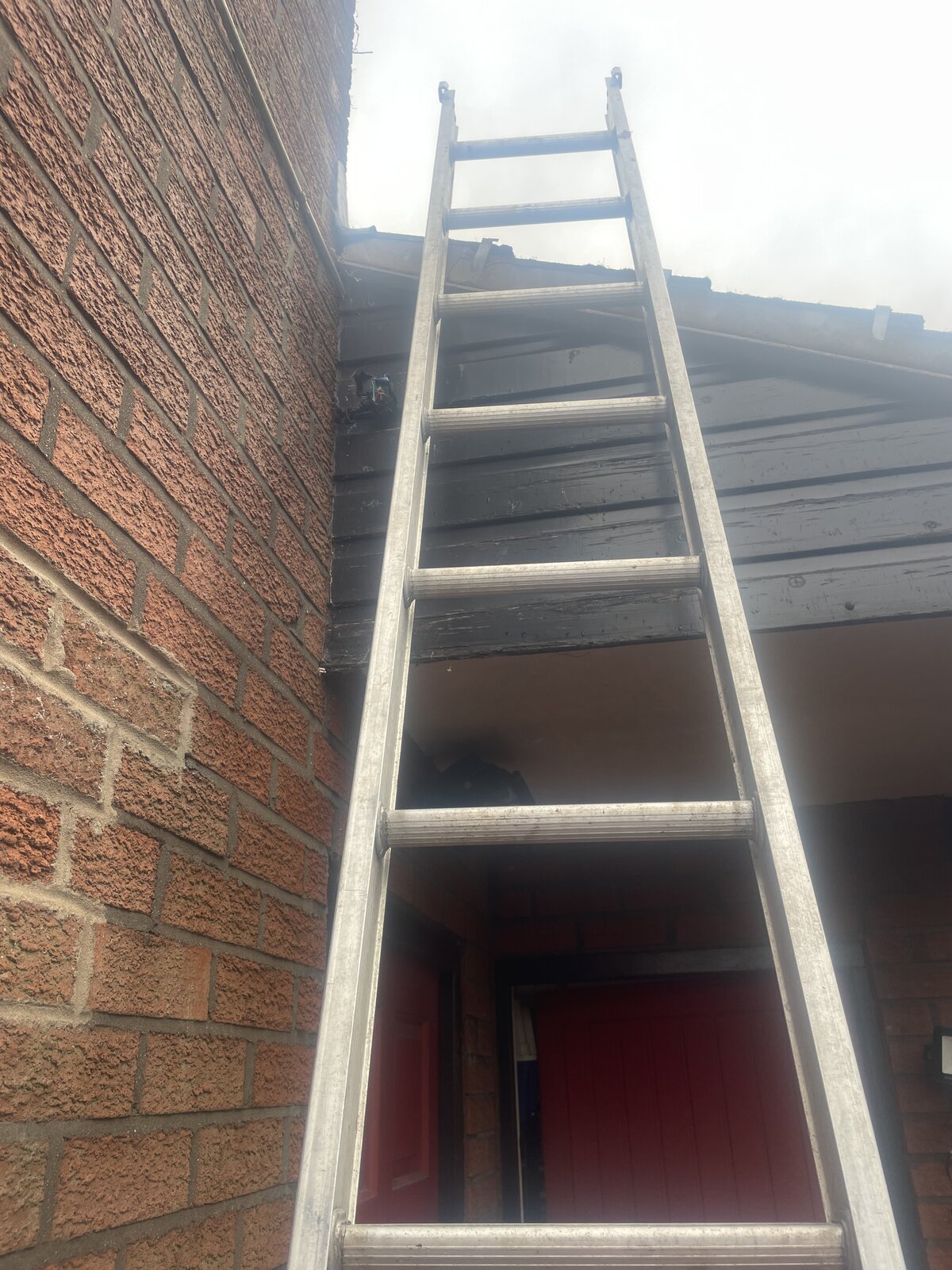

So with the rain

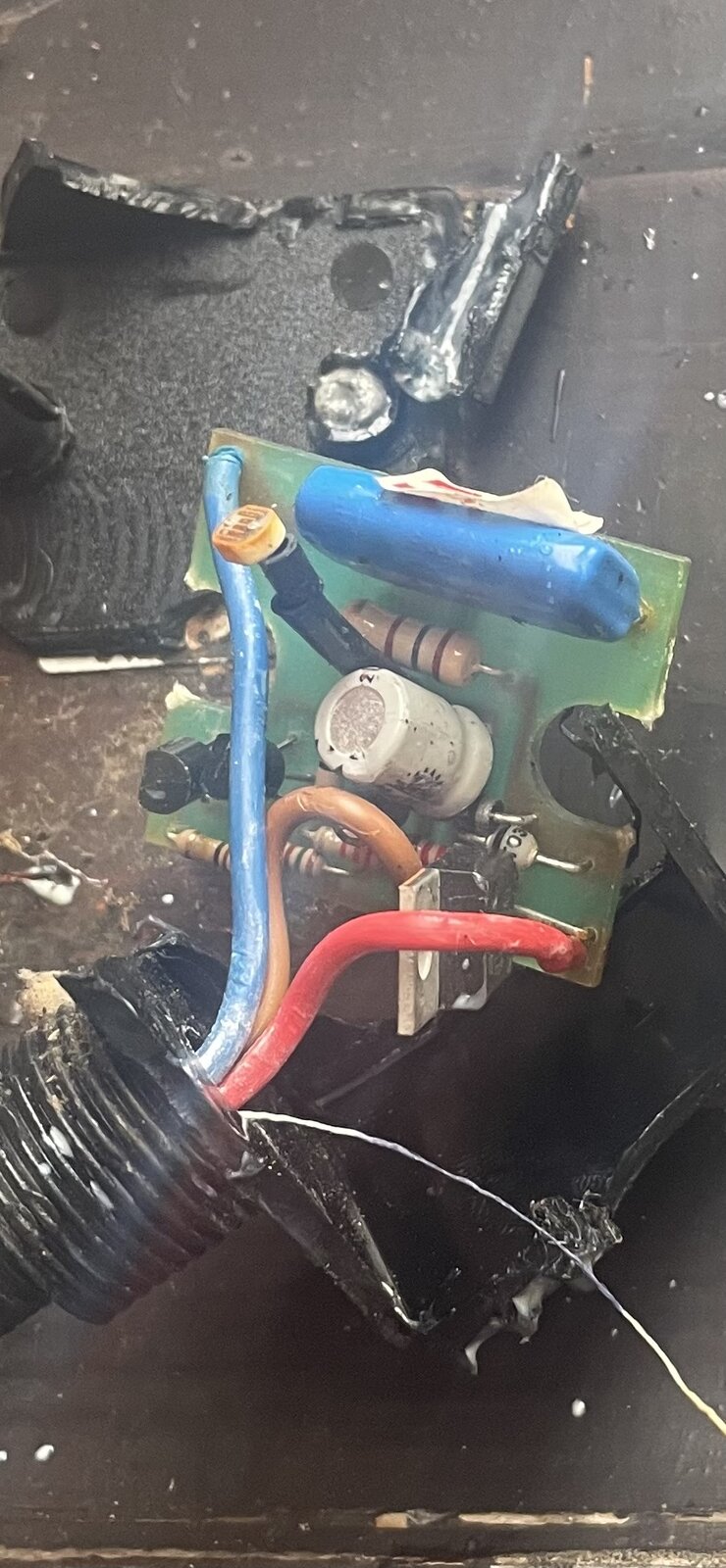

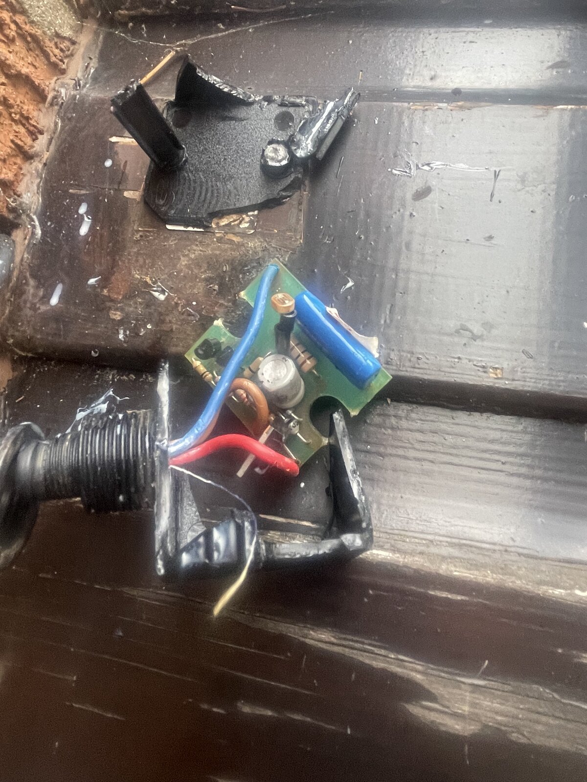

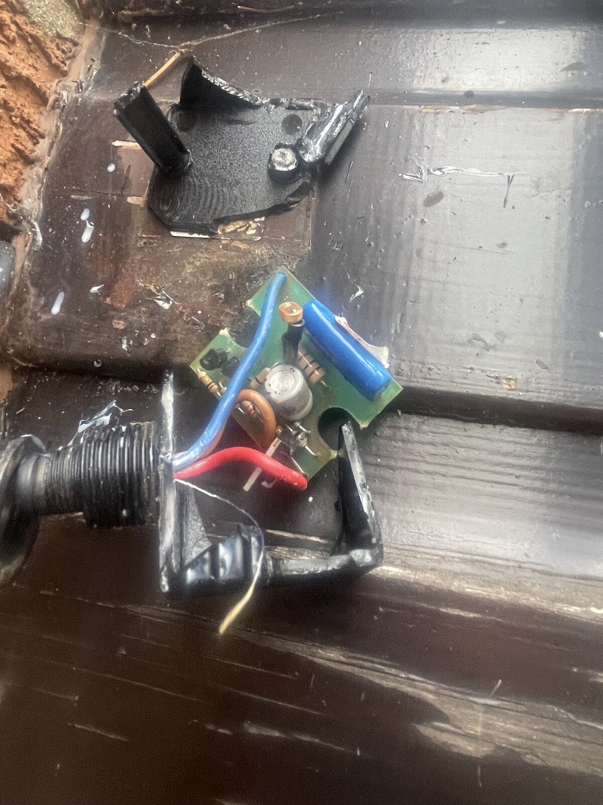

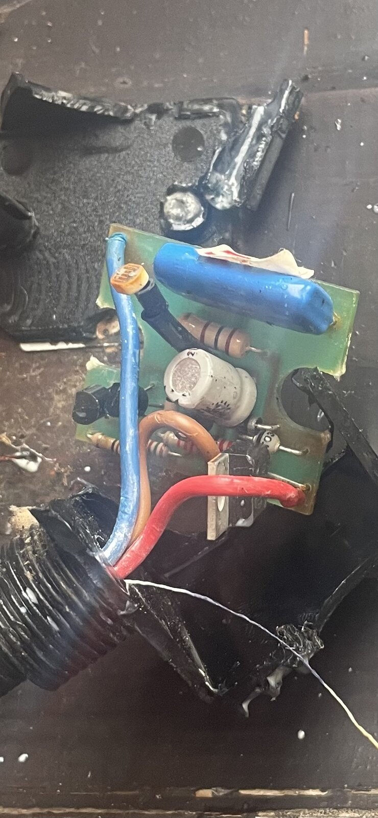

I managed to turn off the elec and get this off. No screws to be found.
This is what I have.
Advice please.

Need to see whats on the other end of those three wires to be certain.
Is there any markings on the box - maker & model number?
Don you have a voltage tester/multimeter?
Its possible that the two reds are power in and out and the blue is neutral, but that is guess work. As a last resort, Cut the three wires and insulate them and see if all of your lights etc still work. If they do then you could assume that is an old thing that is no longer in use.

Or try the insulation technique.

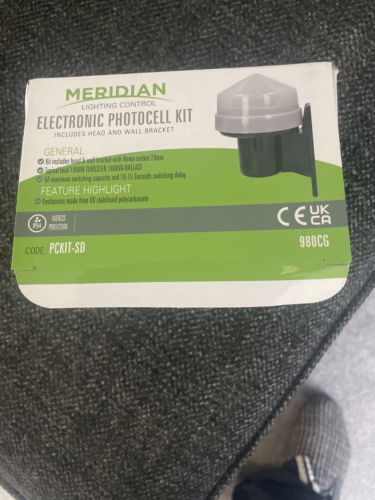

It's another one he has in the garage.
You could connect it up, but you need to know which wire is which and where to isolate to save killing the whole house...
If you work out which are the two lives and put those together, the light(s) should work, assuming the lamp(s) is/ are intact.
But you must find out where to isolate the power from and work safely.
