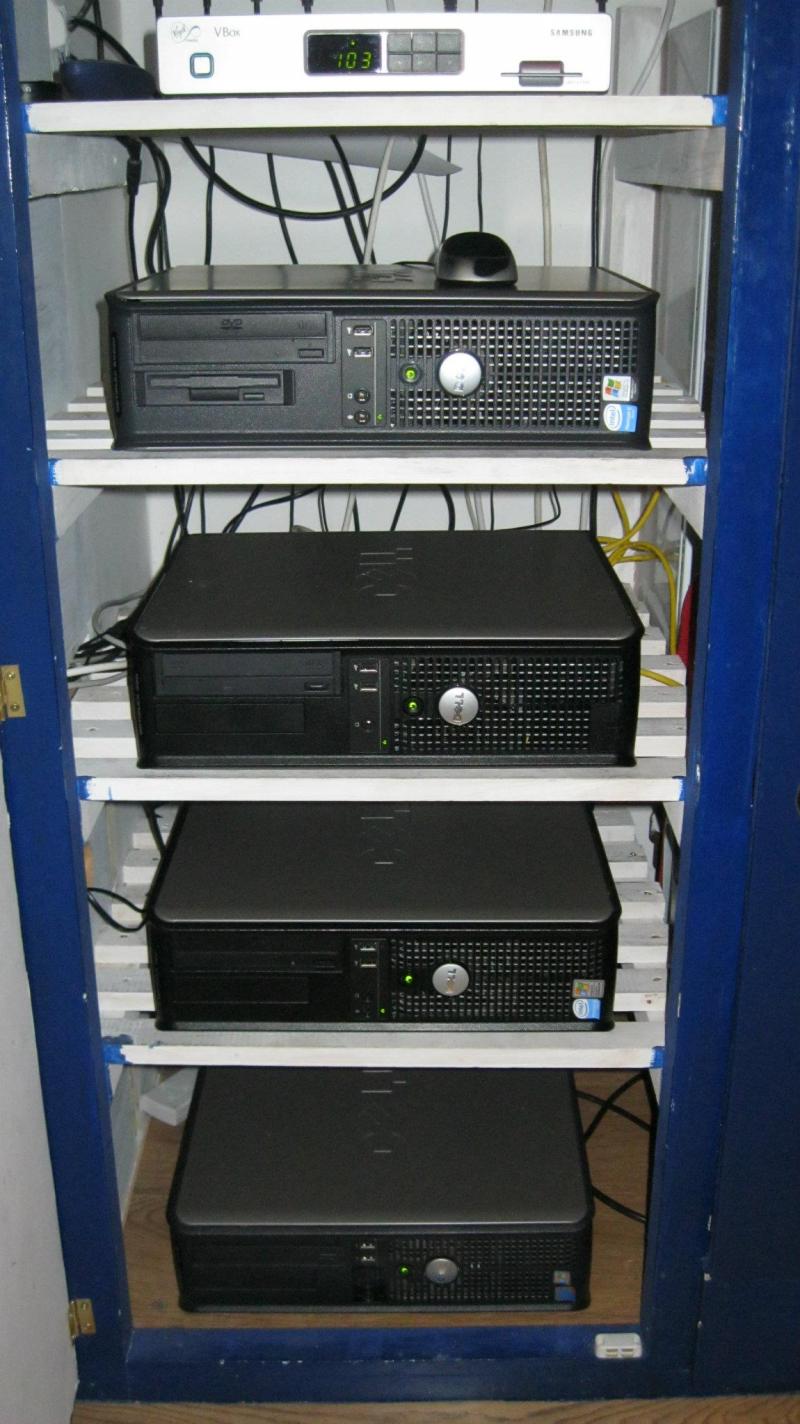

You don't need to buy a new PC, I upgraded all my kids PC's from Ebay
Pentium D which is Dual Core, Sata Drive, 1-2 Gig RAM = £30 - £60, I bought 5 and lowest price was £31 highest was £62 and I have all of them on W7, I wasn't concerned about how much RAM cos DDR2 is quite cheap anyway 2Gig for £10-£15
Example.....and here are mine
