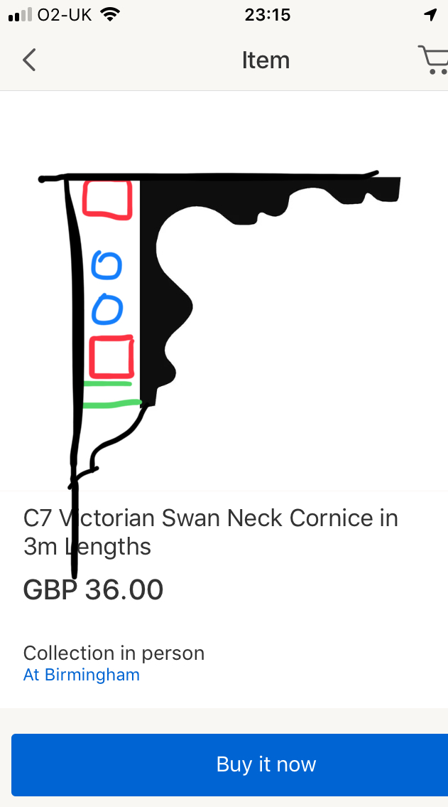

However would it be acceptable to create a Plasterboard service void running all the way round the kitchen and drop down where required from there? Like a small drop ceiling around the perimeter?
Trying to avoid as much channeling as possible... I’ve also got AV cables and external lighting.
See attached sketch

Why a no-no? Cables are permitted within 150mm of the ceiling/wall angle. Only consideration might be proximity of AV cables with mains cables, but should not be a problem.

Ah, a sub-main might be a different matter.
The cables concealed behind coving would have to have an RCD at their source.
This may not be desirable for a sub-main.
Edit - that is unless the cables are armoured or otherwise protected.

Just planning how to best to rewire that wing of the house from the new sub-board (wing sounds posh but it's really not, although it used to be an 8 bedroom house that was split in two so it is quite large) ...
In a nutshell all the sockets as well as an outbuilding are currently on a radial that's been dogged off here there and everywhere so I wanted to tidy it up.
In fairness the main cable could go under the floorboards but if I can create a service channel it makes life a lot easier than lifting every floorboard in the bedroom to drill every joist.
I'm also trying to limited the amount of channeling both inside and out... I have sold walls inside and also render / tyrolene on the outside (which is a bitch to match up).
Tbh the existing sockets could probably be utilised in some cases but I'd still need to add a few and also hide the CCTV cable and external lighting.

Appreciated ... but there's also cables chased into the walls all over the place. I'd say from a risk point of view there's less chance of drilling the coving than the wall?
These are pretty much the same "no no" concerns as I read in the other thread.
Why would it get complicated to clip and cover it with a steel channel?
The cables concealed behind coving would have to have an RCD at their source. This may not be desirable for a sub-main. Edit - that is unless the cables are armoured or otherwise protected.

... The regulation (522.6.202) which requires 'concealed' cables to be in safe zones and to be RCD protected (unless armoured etc.) doesn't actually talk about 'concealed' cables but, rather "..installed in a wall or partition at a depth of less than 50 mm from the surface of the wall or partition".
Does 'behind coving' count as 'installed in a wall/partition' for the purpose of this reg? If so, what about 'concealed' behind trunking which is disguised (sometimes pretty effectively) as a dado rail or skirting etc.?
In common sense terms, I would think that 'behind coving' would, in practice, be at very much less risk than 'within a wall', since I would think that it would be very unusual for anyone to drill/nail/screw/whatever into coving.
