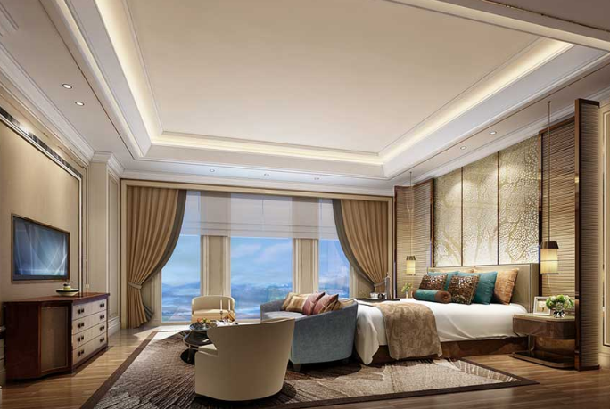

It's quite simple, my electrician needs to run some cables so I'm trying to minimise the disruption to the rest of the house by creating some small voids.
It won't be as lavish as this but something like this on a smaller scale?
Do these not meet regulations?

Some might argue that boxing in take more thought than drilling a hole so is therefore more complicated but I won’t be so pedantic :p
This is one situation where MICC cable for the submain may be useful - it's completely screened, so no interference with AV cabling, it's smaller diameter than armoured, and you may be able to use a smaller conductor size too (with the caveat that if you are running the cable at a higher temperature the terminations must be able to handle that too), and it has a very small bending radius so will go round corners inside coving.
Personally although I have happily used standard plaster coving for power and lighting cable up to 32A on RCD, I wouldn't be happy about a submain. That's an awfully big bang if it's drilled into.

What's also very simple is that the only person who can tell you what is acceptable and what is not is your electrician.
He will be the one signing an EIC to say that he was responsible for the work and that it complies with the Wiring Regulations, and that includes design.
When he notifies the work to the council he will be declaring that it complied with the Wiring Regulations, so the EIC has to be valid.
Just ask him.
Or show him the route - you might be surprised what he can do.
