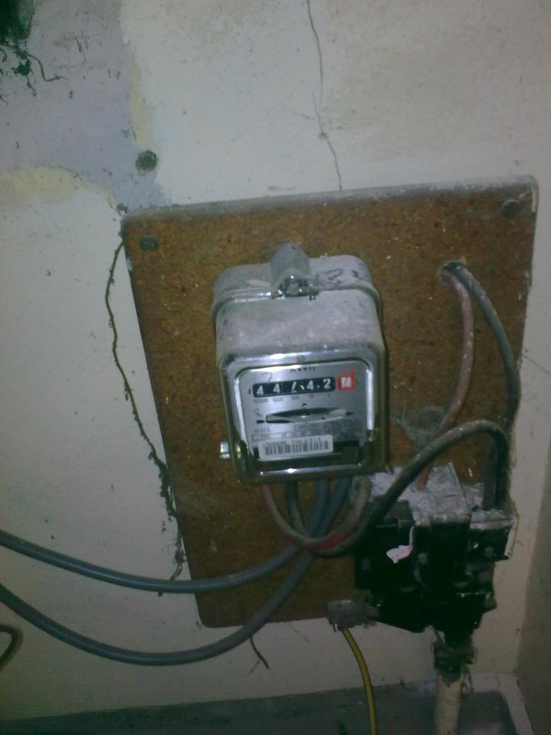

This is a commercial property with a residential flat above. The service comes into the commercial property and is then looped from the service head up to the flat above. It is buried in the wall in a steel tube, probably a scaffold tube they found on site when they were being built.

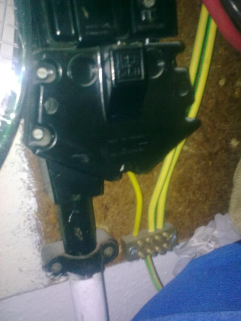

You can see in the second picture that there are no cables other than the ones coming from the meter.
Standing outside my front door, i can see 12 propertys like this and there are 15, 3 story blocks of flats close by that are connected the same. I know of a town close by with loads of social housing flats connected the same way.
That totally fails to meet any modern standards.
1/ topside loop to the flat above so flat tenant does not have 24hr access to main fuse (big problem if it blows out of hours)
2/ two customers "sharing" the same main fuse, they should have one each
3/ Singles going up to flat possible in an unearthed pipe and no sign of an earth going to the flat.
Though there is no need for the REC to take retrospective action unless major work is planned at the address.
(at least there is a (max 100A) fuse protecting the cables in the pipe!)
I know of this property because we recently re-wired one of the comercial property, a Laundrette. We had concerns about the rising cable and called the DNO. They attended and said that the cable was in a servisable condition. We asked him to trace the cable up the wall as we wanted to mount some equipment on it and when he tried with the underground tester it would not detect after 18" and he said it was because it was in a steel tube
It is on its own seperate fuse if you look closley
They have
3/ Singles going up to flat possible in an unearthed pipe and no sign of an earth going to the flat above
So on a PME, overhead supply, how many conductors are there?????????
Just went and asked the people above the property from the pictures i posted if i could take a pic of there servise head. You can see it is PME coming from the bottom of the N block and yes that is a steel tube going into the head, not plastic
