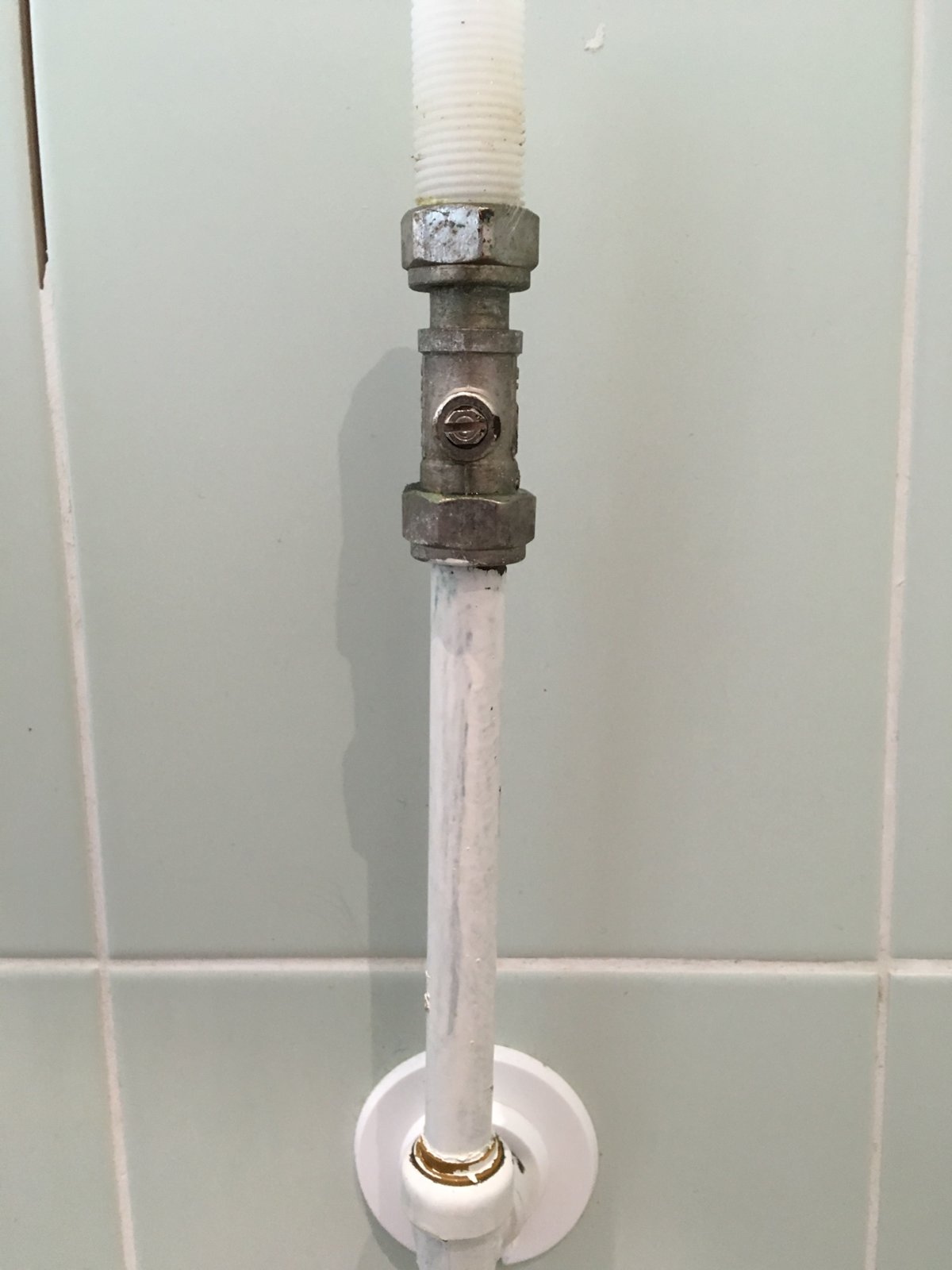

This all started with toilet leaking at waste connection, so involved removing cistern and toilet.
When undoing the fill valve it fractured just above the photo, but I want to fit a new service valve anyway to replace the grungey old one.
Problem is the supply pipe is inserted into some kind of fitting (push-on?) at the tiles on wall, so if I turn the compression nut that entire pipe (15mm copper) just revolves with the service valve. I can't understand how it was tightened in first place without any counterhold?
How do I undo the old service valve from the supply pipe and fit then new (better quality) one I have ready?
Thanks for any advice. This should be simple but I don't want to make a false move and fracture the supply pipe!
Put a spanner on the flats just above the on/off slot to hold the body and use another spanner to undo the top and bottom nuts.
Thank you I know they look like flats above the on/off slot, but it's just trick of the markings and it's perfectly round same as below the slot. The better valve I bought does have proper flats machined on body!
There are roughly flatted areas in centre of valve, but they're not designed as such so when I try to get grip on them the whole body rotates.

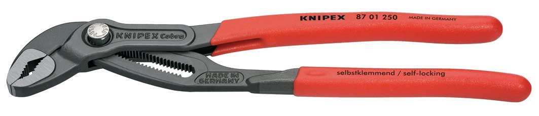

make sure you have turned water supply off and drained pipework before you release the joint on the isolator valve. you need a pair of grips to hold the body and a spanner on the nut .
Thanks flameport I have grips just like that so they should give me better purchase on the body.
Also realised I could cut the pipe where it enters valve, but may then be too short to reach inlet valve connector but no room for a flexible service valve pipe.
