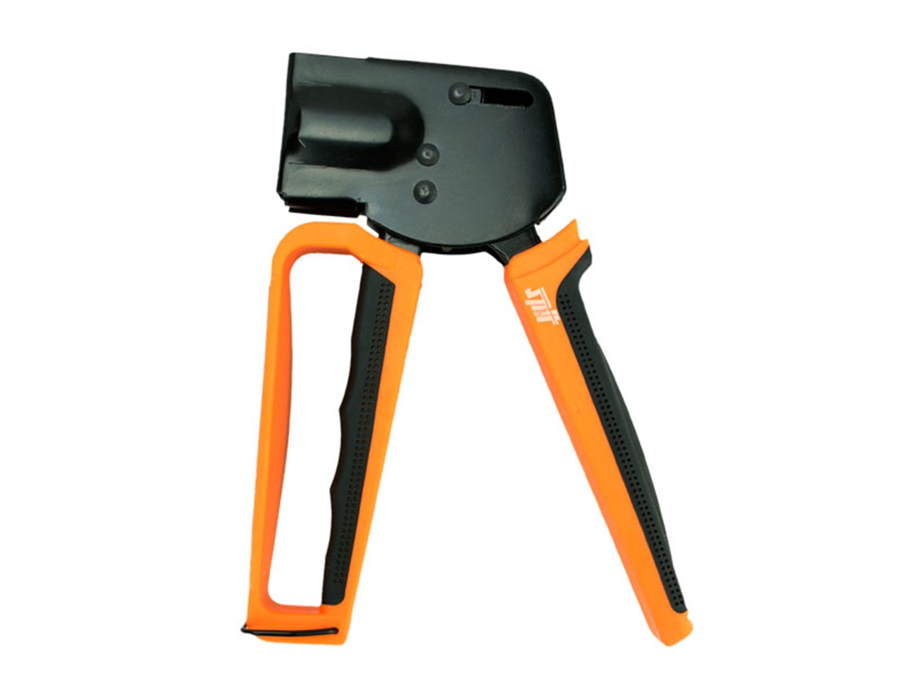

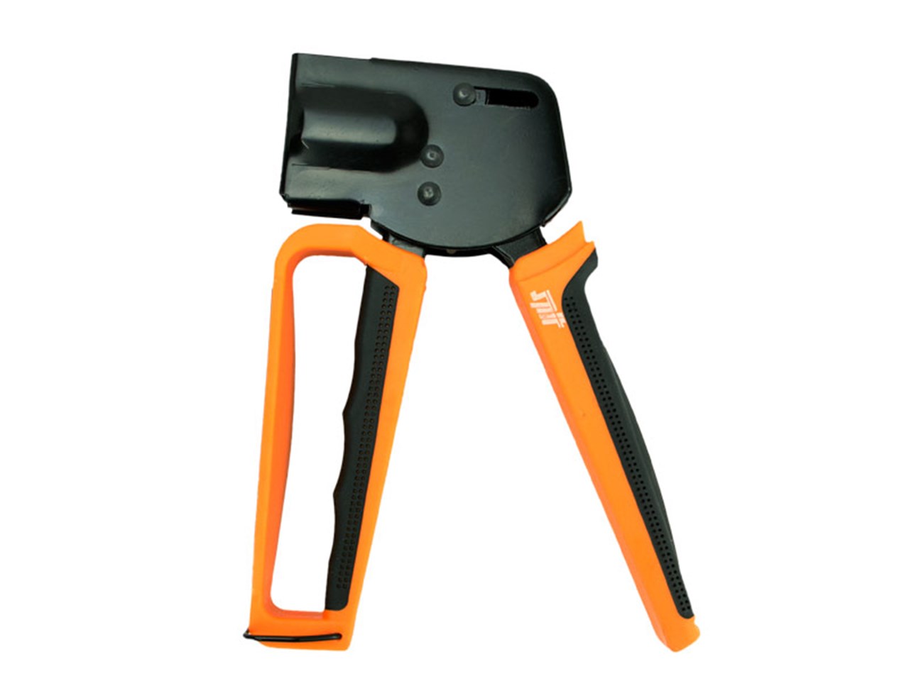

On the flip side I have a newer tool, a Spit Zentech setting tool, which we were given free by the distributor. I've used it a few times and it seems to be slightly better than the newer Rawl (and a lot better than some of the no-name Chinese carp I've come across). Maybe that would suit you. Can't say how good it will be, though, as I haven't yet done dozens of anchors with it

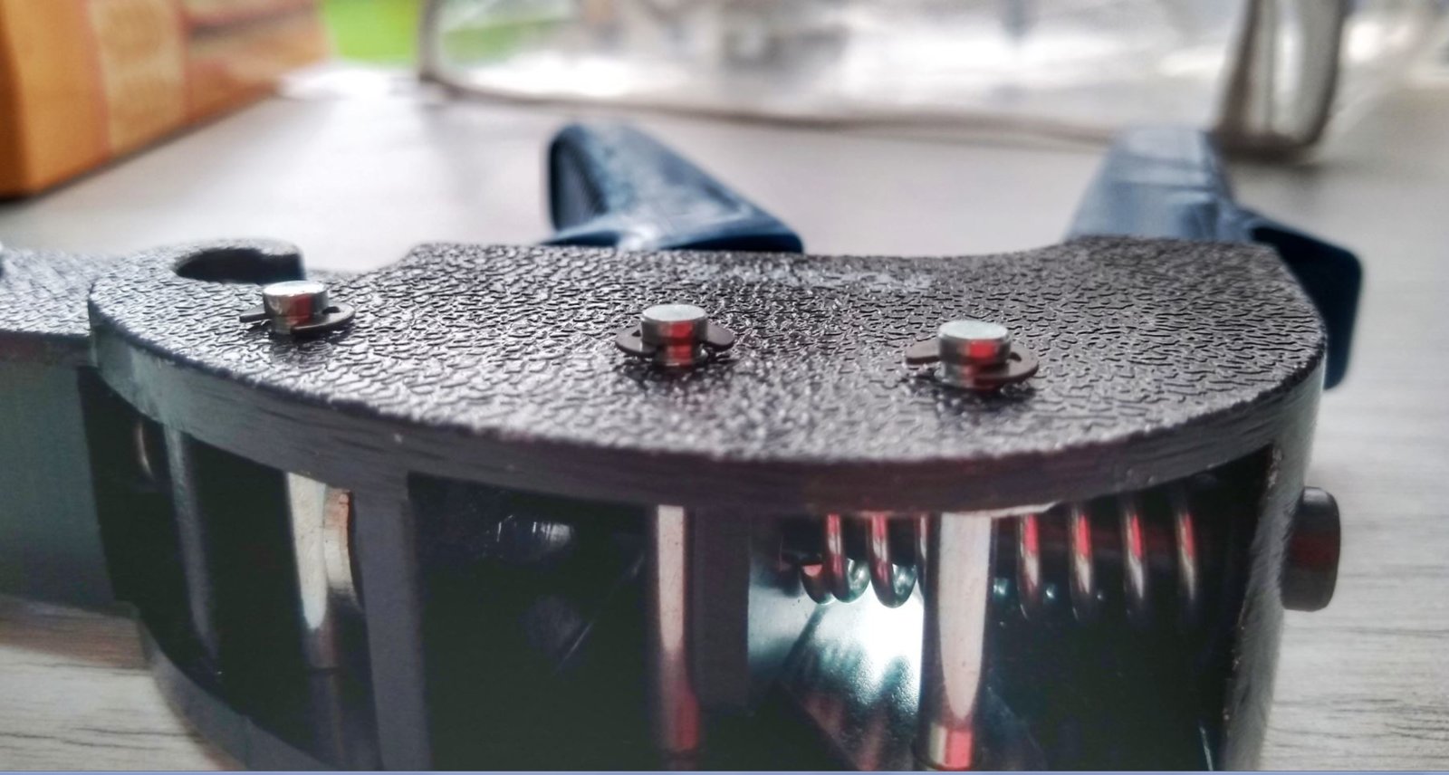

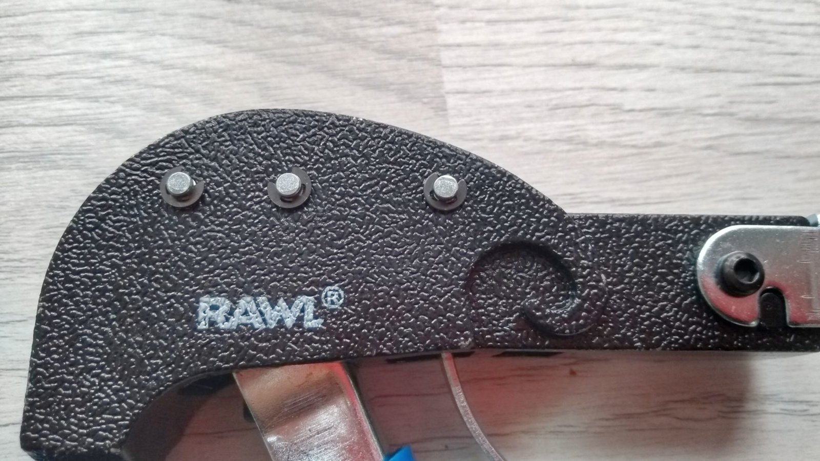

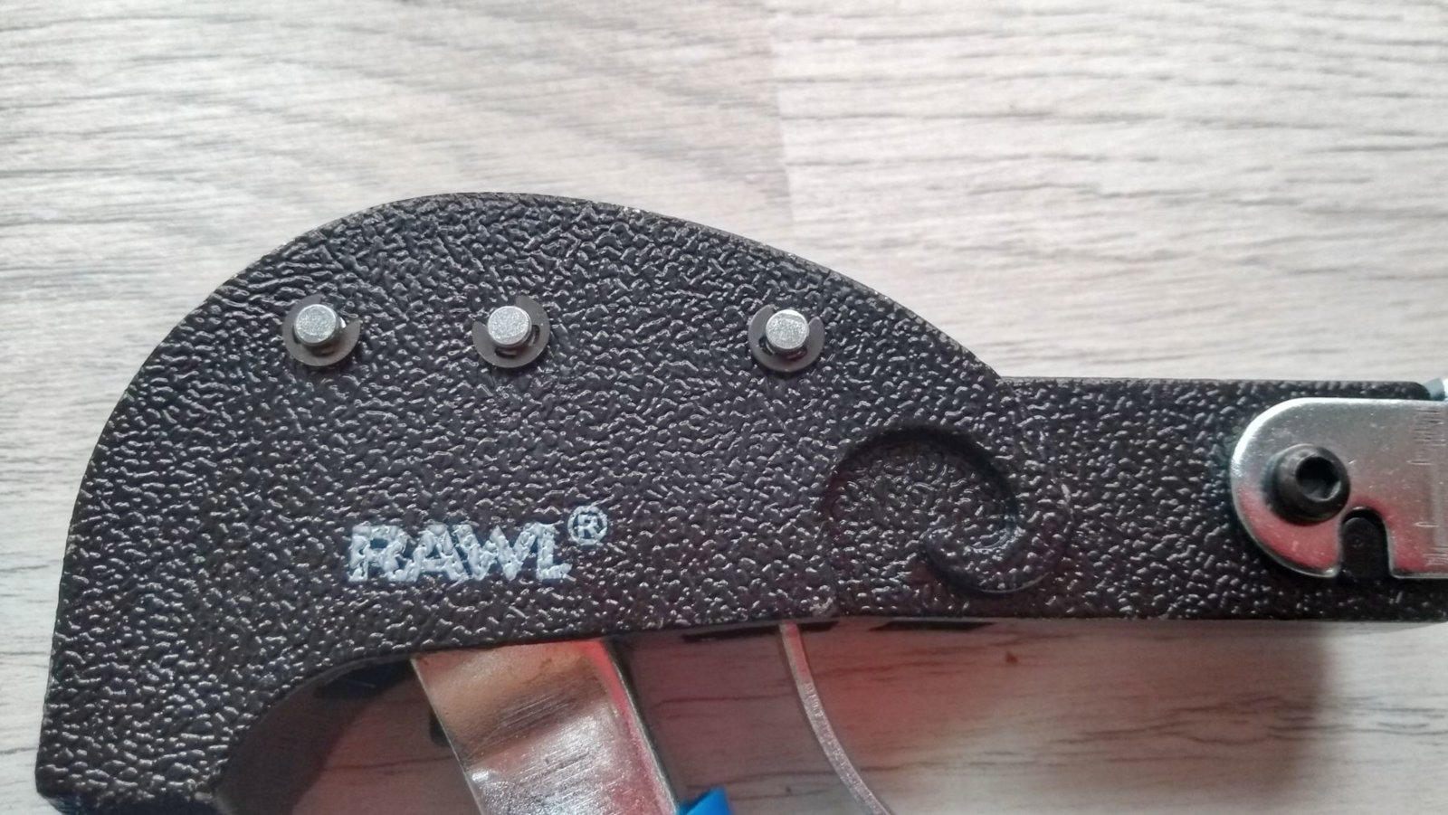

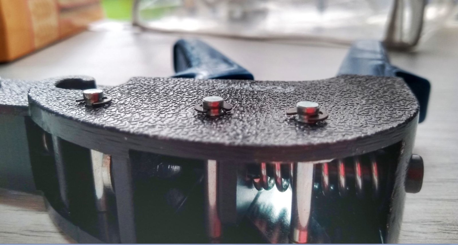

Update. Thanks for all the input. I went for the Rawlplug one from screwfix at £13.95. I can see the circlips that people say fall off and so will keep an eye on them and if they fall off out of warranty then I will just pop a new clip on.
Finally got around to posting some pictures, may be helpful for others.
Dont seem a lot that can break on it apart from the issue with the circlips which I will keep an eye on and replace if they fall off.
I did find that I was over squeezing and heard some part of the fixing give way behind the plasterboard but it still held ok
