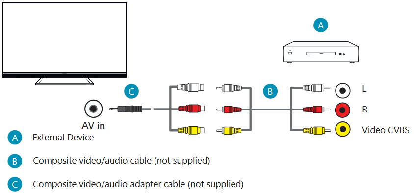

Old TV 42" new TV 55" both cheap Black Friday deals, new one Sharp Aquos, three HDMI leads, satellite lead, terrestrial aerial lead, and connects to Wi-Fi and Bluetooth. It says mini AV, 1764710646129.pngI assume I need some special cable? I have a composite video/audio cable to SCART, but not what looks like a jack plug to composite video/audio cable, not 100% sure what I will need? I have a DVD/CD player with surround sound, with SCART I am not sure, if worth getting it connected?

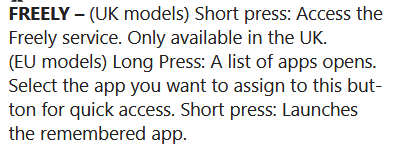

It has Freely 1764711552189.pngand not sure if watching terrestrial or Wi-Fi TV, up to now Freeserve from Moel-y-Parc has been rubbish, with very few programs, we now seem to have more than old TV, so may be this Freely?
Turn your router off, to find out which.

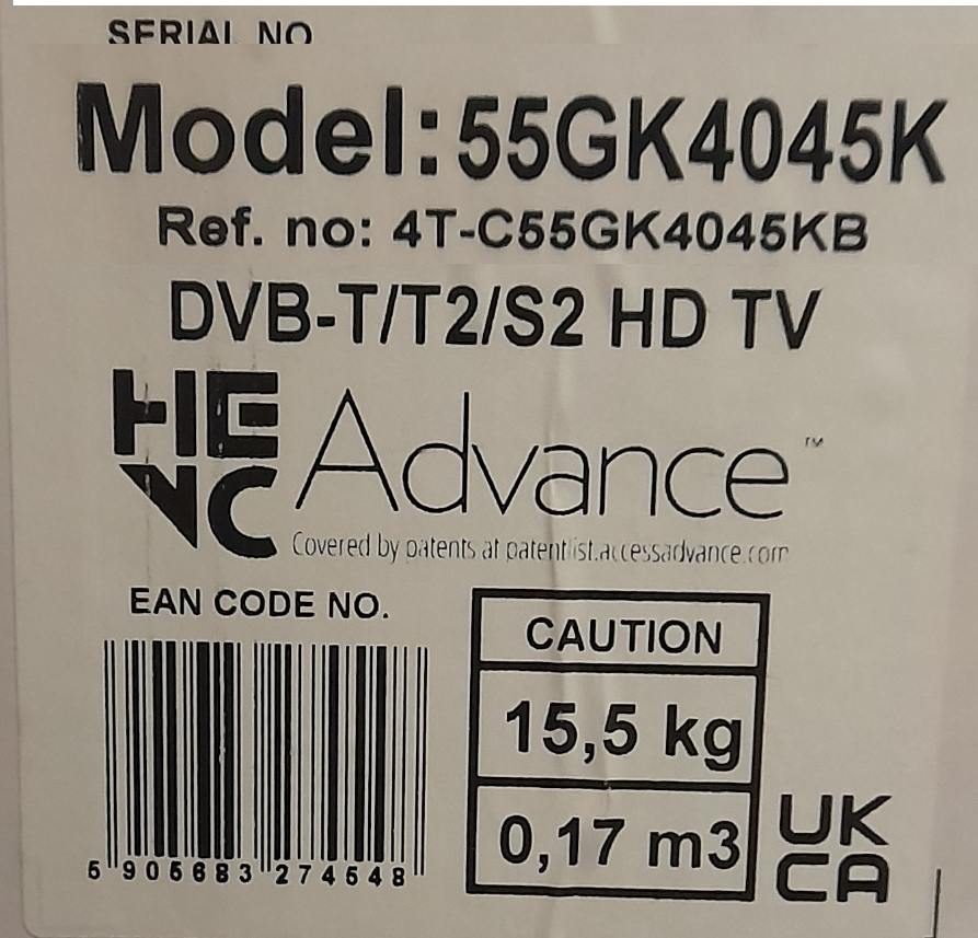

I've just wasted 10 minutes checking four different Sharp 55" Freely TVs for the AV input. The models are 55HJ4225K, 55HJ4125K, 55HJ4325K, and 55HJ4725K. All the specs say the same thing. "Video/Audio input (3 x RCA) - Yes" None say it's a minijack.
I'm not being funny, but you're wasting everyone's time if you not going to bother writing the model number in your post. You've been a member of this forum for long enough to know how it works. If someone asked a radio ham question, but never bothered to filling in what gear and antenna they were using, you'd be equally frustrated. Come on. Play the game. Give us your bloody model number if you want help on this stuff.

You need a 3x RCA cable that plugs into the back of the DVD player. On the other end, you'll need a female RCA to mini AV (3.5mm) adapter. Then, the mini AV end (3.5mm) will connect to the back of the TV.
If you already have a 3x RCA to RCA cable, then all you need is the female RCA to mini AV (3.5mm) adapter, and it will allow you to connect the DVD player (via RCA) to the TV (via mini AV).

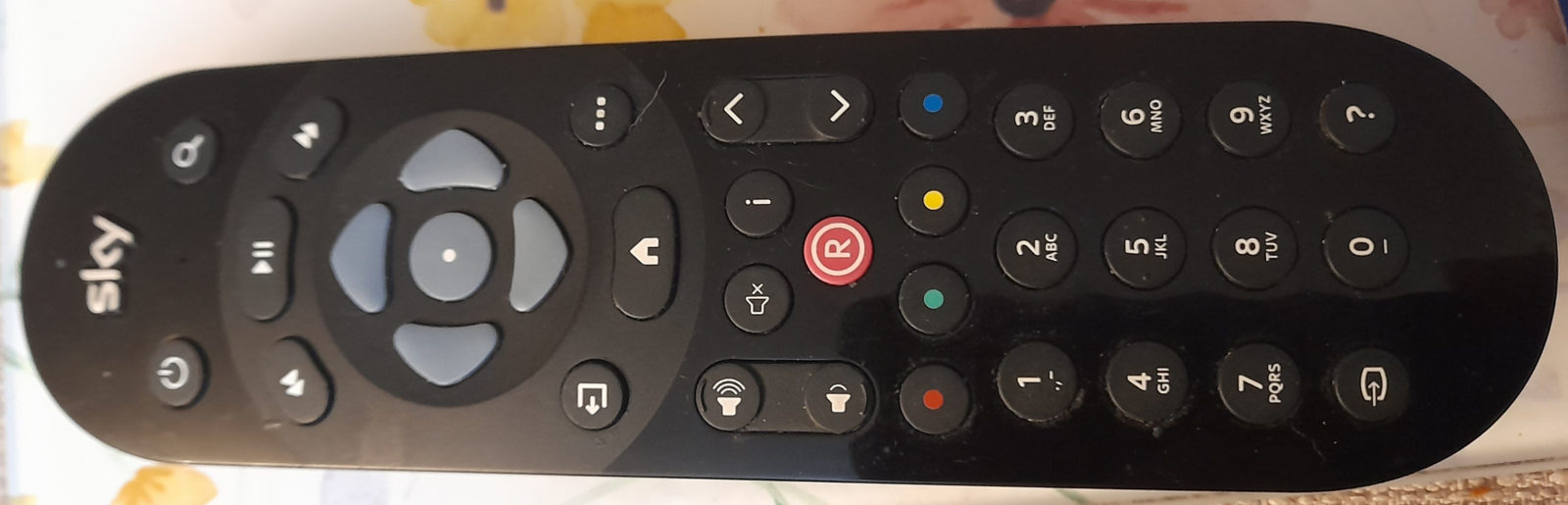

but the volume button on the Sky remote does not work. And switching on Sky box does not auto start TV.
It needs programming to the TV. If you remove the back cover of the Sky remote, there should be steps that guide you how to do it.

Sorry, box was not to hand, 1764796413397.png I looked for details on the instructions, and they were not shown. I am slowly masking all the useless channels on free to air, but as yet failed to get Blu-ray player to work. And the Sky remote is not controlling volume, and can't remember how it is done.1764796833881.png I am sure I will find it. Don't bother looking for me.
Sky HD box remote, needs to be set to control TV. Google it..Will control sound & turn tv off

Remote now working Sky and TV, so that bit sorted. The satellite slowly removing the encrypted and god and sex channels, so becoming useable. But never really thought that changing a TV set would involve so much, was the extra few inches worth it? I was finding it hard to read the guide on the TV and wife thought it would be better to have a larger TV rather than better glasses.
