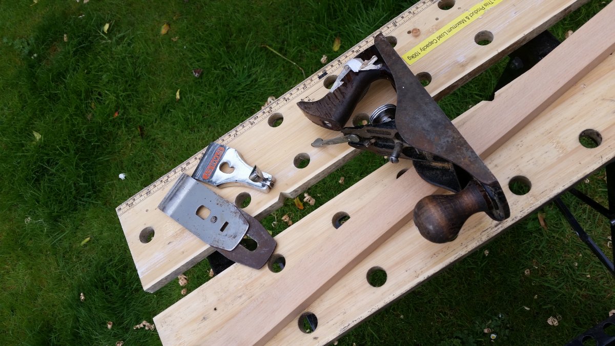

Just wondering the best way to set up a planer. Is ilthe blade totally in when bot using so blade pulled in as far as u go and to set it up do u just line up the blade a fraction poking out - check with finger then push the frog or latch down to tighten? I can't seem to make a difference or use the the round adjuster thing- doesn't seem to do it. On another planer when I set it up like I explained above the blade seems to move in; it doesn't stay in place.
Set the cap iron closer to the blade edge....around 2mm will do.
Then, operate the thumb wheel - that's fixed to the frog - and see that the lever moves - that will engage in the cap iron and push it out of the sole to get a rough cut.
Assemble your plane, but keep the sprung cap on the loose side so the blade can actually still move.....adjust the large screw to set this.
The plane blade should now retract without any problems.
The lever above the thumb wheel engages with the blade so it can be centralised. Don't be scared of keeping the plane well sprayed with WD40 or similar.

Don't get what u mean by set the cap iron close to blade edge say 2 mm. Thanks for other explanations though
Looking at the blade and cap iron assembly - the items on the left of your picture - they are held together by a large screw.....you can see the thread but not the head which is on the other side. Undo the screw and the items will part.
After sharpening, set the supporting cap iron just back from the blade edge (2mm or slightly less) and retighten the screw. This forms the shaving 'curl' as the plane is used.
The other large screw on the plane body itself adjusts the pressure on the blade assembly.....set it so you can turn the thumbwheel easily but the blade doesn't float around.

These two bits set 2mm apart?
When you release the brass screw the cap iron slides up and down.

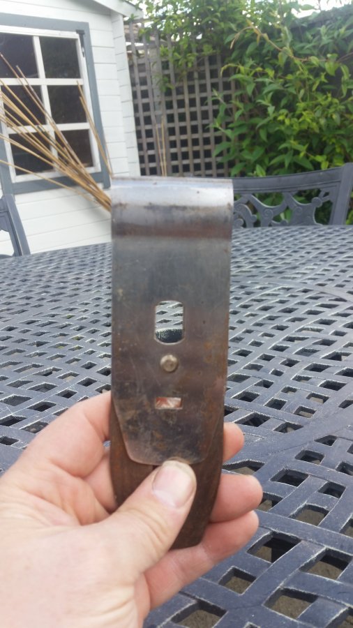

And you want 2 mm between the tip of sharp edge and top of other bit?

The blade doesn't look to be ground square, unless its my eyes! No huge deal but set the cap iron parallel to the blade edge and then its adjusted by the lever above the thumb wheel that positions the blade.....squint down the sole to see where the blade is.
(That's easier said than done, and sharpening / honing is a skill on its own....a bit easier when you've done it all your life!)
Your emery cloth is just fine, use some WD and wipe afterwards.
