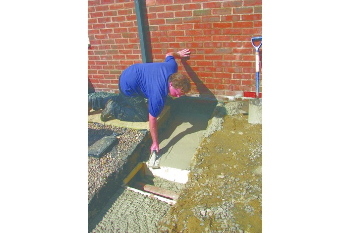

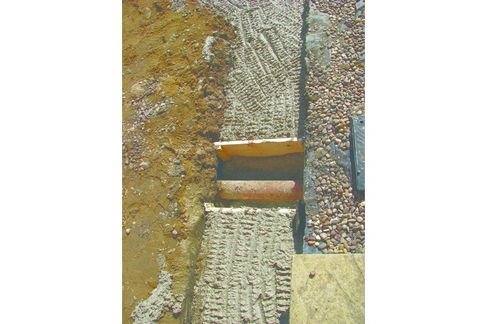

Is this what you are talking about. I found this on the internet! Would this not cause problems if the ground moves more on one side, it will cause cracks above in the block work.

Bridge a lintel over the pipe where the pipe passes under the wall.

You would either step the concrete and have deeper masonry around the pipe and lintel over it.
Or form a hole for the pipe in the strip when you cast the concrete.
With either method you need to be careful not to create a weak point in the concrete which causes it to crack when it initially settles or later during seasonal movement.
The trench will be 600 deep, 300mm thickness of concrete with 2 course of block above to dpc level. The strip foundation will be a ring right around teh building on the same level without any steps. When you steps, what do you mean?
When you say form a hold, is this as in pic above o as i mentioned to the other poster?
