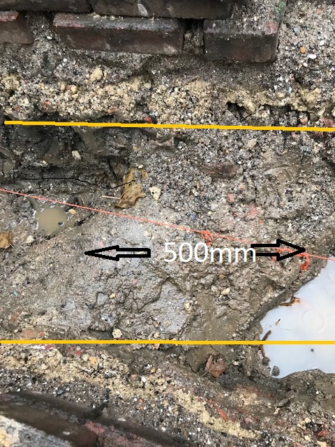

Sewer pipe going through footings
Ok guys I haven't been able to dig down anymore as the rain has never stopped, but I have took a quick pic if that will help :-)
I would be inclined to pour the concrete in 2 stages and bridge the pipe as it goes across if i see it correctly.
Unless you go deep enough to stop the concrete below the pipe.
Did you say how deep it is?

I planned to dig down to the bottom of the concreate surrounding the pipe, and build up to ground level with blocks on the footings, (unless advised by you lot different ) ;-p but need to sort something with that dam pipe :rolleyes:

Pour concrete in 2 session doesn't mean either side of the pipe.
Of course it means up to 50-75mm to bottom of the pipe.
Then bridge pipe, then pour rest of concrete to required level.
To belt and brace steel rods coild also be used but not necessary.

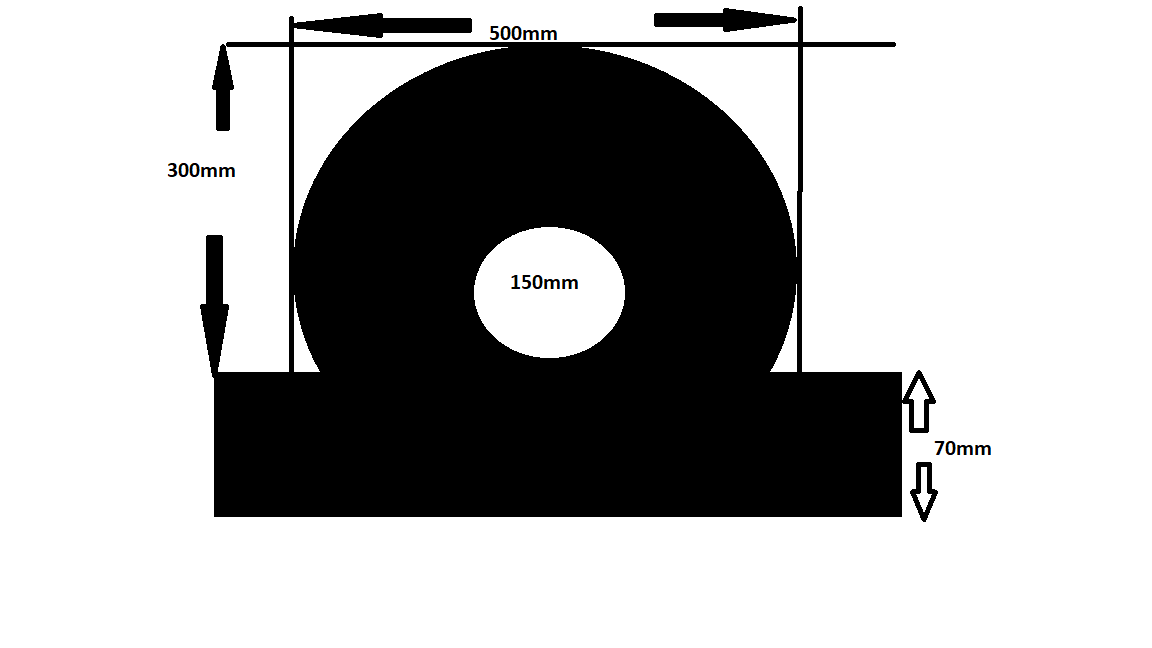

Ok peeps thanks everyone for you input so far all appreciated, however a little off the mark from my original question from some :-)
So lets just say I have every permit / agreement needed, what wound be the best option? I have dug down further and found as I suspected it all sits on a 70mm footing, I have knocked up a quick drawing with the sizes.
How deep are your fundations?
I mean, how far further down than the 70mm are you going?
To be honest, the fact that the pipe is covered in concrete doesn't help.
I suppose it's a clay pipe, not plastic.
Can you confirm?
