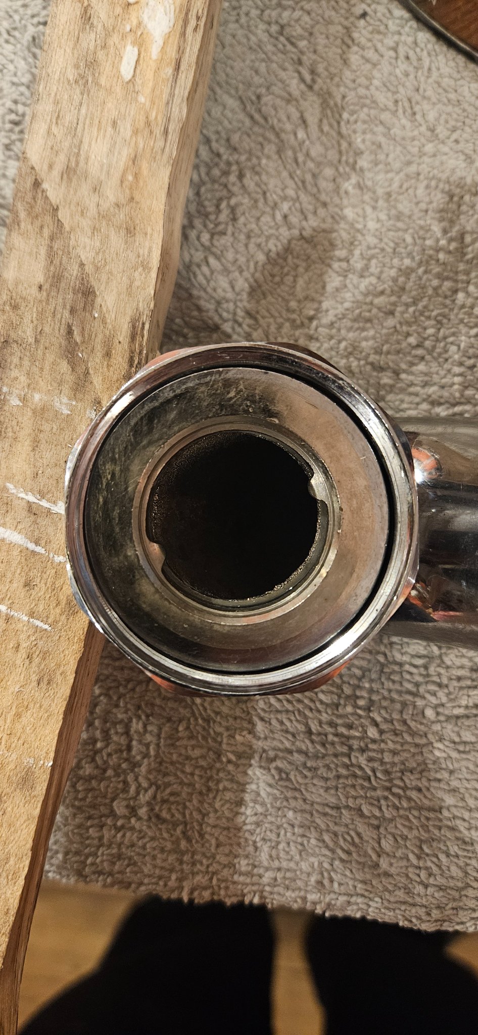

Just in the process of finally fitting the bath in to seal it and I realised I couldnt find the washer that goes between the bath outlet and the shallow waste
the part number ht03-10 in the diagram.
I thought I had found a replacement washer from the old pillar tap (well it fitted) but no such luck.
Took the waste apart and rushed to screwfix- bugger its Saturday, closed!!!
So last hour I have been trying to find one.
The sizes make no sense at all to me as some are in mm and others are in inches - which I get.
But when I search for 1 1/2 sealing washers I get washers with 71 outer diameter.
The fitting I have (see photo) has 1 3/4" threaded nut, outer diameter of 44 (poss 45mm) and inner diameter of27mm and a thickness of 8mm
I have searched and searched yet cant seem to find the exact thing that matches,

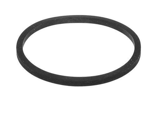

You need a trap inlet washer.38mm i think.Measure inside that nut and see.
the inside of the nut (the outside of the metal flange) is 44mm
Sorry that sounded rude, should the washer not align with the threaded pipe coming from the pipe (so it crushes against it)? or should it sit within the pipe?
It sits inside the nut and pushes tight against the bath waste when you tighten.
Thanks for that.
Silly question, but I seem to remember the washer being more of a flat washer. Is there a difference (I am sure there is) and does it matter so long as it seals?
Measure the diameter of your bath waste and the washer needs to fit inside the trap but seal against that waste fitting.
It will be a flat washer with that flat face on the inside of the trap, the washer linked to above is more for say a McAlpine 11/2" bsp sealing nut with a recess that the seal sits in or a trap that has a raised shank and ridged shoulder that fits inside the bath waste up to the shoulder and the seals sits on that shoulder and is compressed up onto the edge of the waste when tightened.
You will be correct is suggesting that trap would be likely to have a flat wide washer to give a proper seal on that type of flat face.
1 1/2" (size of the waste nut from the trap diag) is ~38mm so a 40mm flat washer should do the job, if the sizes are true.

I have just checked the outside of the nut (ie what spanner size) is 2"
The inside is 44mm so i have ordered these
with the former seeming to be the perfect size.
would either do and if so any particular one over the other?
Would a bit of plumbers mait help as well? Bearing in mind it sometimes has to be undone for hair removal
Thanks so much
Wrap PTFE round the trap where the washer should be. Make it thick enough and it will make a seal.
As long as the washer is large enough so the edge of the bath waste sits on it so when it's tightened it forms the seal then that'll be large enough. If the bath waste has a sharp edge then don't overtighten the nut so it cuts into the sealing washer or file the edge flat, that'll be easy as the waste will be brass. .
Thanks for all your help!!
A combination of the 3/4" tap pillar washer, ptfe tape and plumbers mait have sealed it all.
