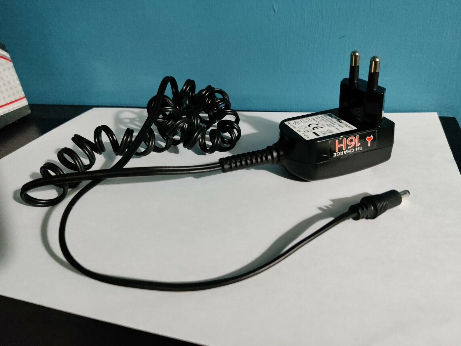

Although not technically a shaver plug 1672478812261.png most shaver sockets will take the Euro Plug as well as proper shaver plug.

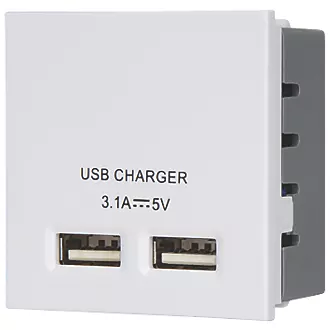

There is also a USB option.
Often the wall mart power supplies come with exchangeable bases, so you select what type of socket it plugs into. I must admit I normally discard the non British, and I would say hanging a power supply from a socket is not the best option.
Technically this 1672479528444.png 1672479577940.pngis not permitted, as it does not have the correct BS EN number on it, Screwfix 42092 and 151CC but if I needed to charge/use shaver in the bathroom, that is what I would fit, even if not technically permitted.
However any EICR will likely list it as not complying.

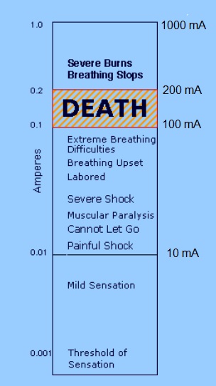

It is not a given that a 30mA RCD will prevent death from electric shock.
From another "old" source ( 1987 ) https://www.asc.ohio-state.edu/physics/p616/safety/fatal_current.html
quote
Above 200 milliamps, the muscular contractions are so severe that the heart is forcibly clamped during the shock. This clamping protects the heart from going into ventricular fibrillation, and the victim's chances for survival are good
end quote
provided medical aid arrives promptly
