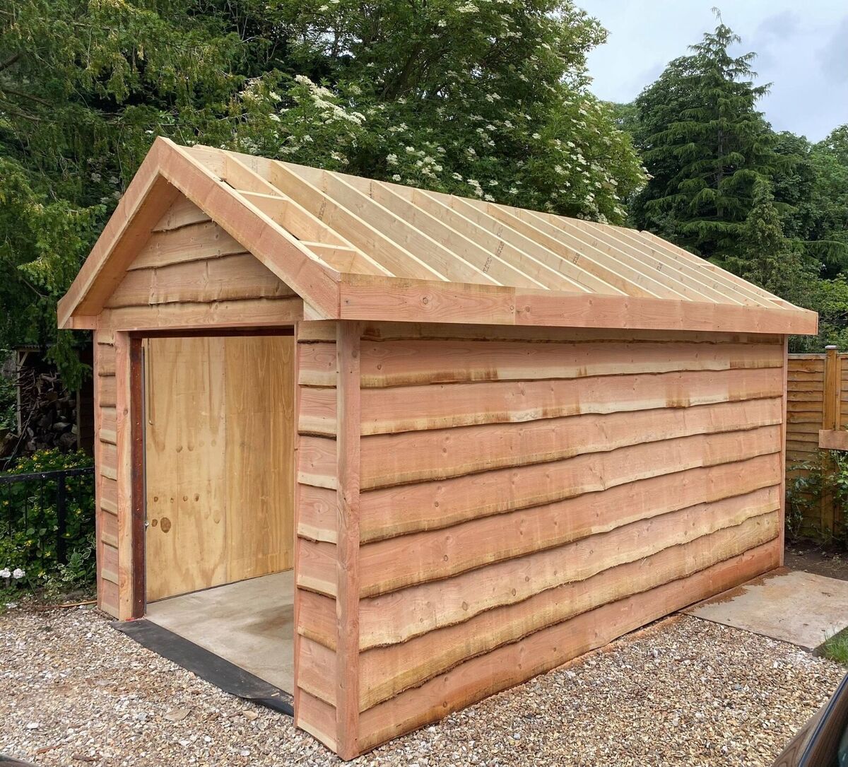

Hi, I'd like to build a shed similar to this photo (ideally a dual pitch roof as photo but may need to do a monopitch, if that changes anything) but I would have double doors at both ends in order to retain front to back access on the property. Would I need to reinforce the building in any way due to the two large openings onopposite ends? The shed would be approx 2m wide (where the doors will be. doors approx 1.2-1.6m wide (whatever is possible)) and 3.6m deep, 2.5m high.
Thanks!

my thoughts
at least 200 preferably 300mm or more say 12mm ply around the inner arch off the door each side and over the top to prevent racking
iff a separate bit over the top solidly joined along the ply edge [joined on say 39/44/51mm width timber 4 or 5 screws in the 200 to300mm
Yes just consider your bracing, perhaps consider some diagonal bracing at roof level too and as above some plywood or OSB sheathing on the ends. What's the exposure like, is it exposed particularly or in between say a fence and the house wall?
It's quite sheltered, between a brick wall and the house.
When you say diagonal in the roof... I can't picture that. Diagonal from where to where? Or rafter to rafter?
Excuse my slow brain. It's bedtime but these questions pop into my head at inopportune moments!
because you want through access you are more likely to hang stuff off the wall this will automatically cause racking iff any slack or ability to move in the structure
light stuff will be fine and better iff on both sides to help ballance up
once assembled and complete push firmly on the side and if it creaks and moves thats what load on the inside wall will do and it wont spring back when you let go

Are you building the roof with trusses of some kind? If so you can fix a couple of diagonal braces on the top or bottom of the bottom chord (of the trusses).
If we do an apex roof, we'll have rafters with an OSB triangle at the top of each set. Didn't intend on full trusses. It's such a small width. If we go flat/mono pitch, we'd probably build flat and add fittings.

you will be fine with double doors
just go in with your eyes open
as a back up providing the doors open out you can retrofit an "A" frame going from the apex to half way up the sides if necessary
yes you will slightly encroach in the top doorway corner each side but well away from where your head will go
You could consider anchoring it to the house or wall.
Not possible unfortuantely. Wall is not ours and the area the shed is on is raised up to 1st floor (and the 1st floor is mansard with tiles!) Lots of complications with this house as we are on a hill. The front garden is raised 75cm, he back garden is raised 1m on the left and 2.5m on the right :LOL:
I forgot to mention, we would sheath the outside with OSB before cladding (not just featheredge board on frame) if that changes anything?
