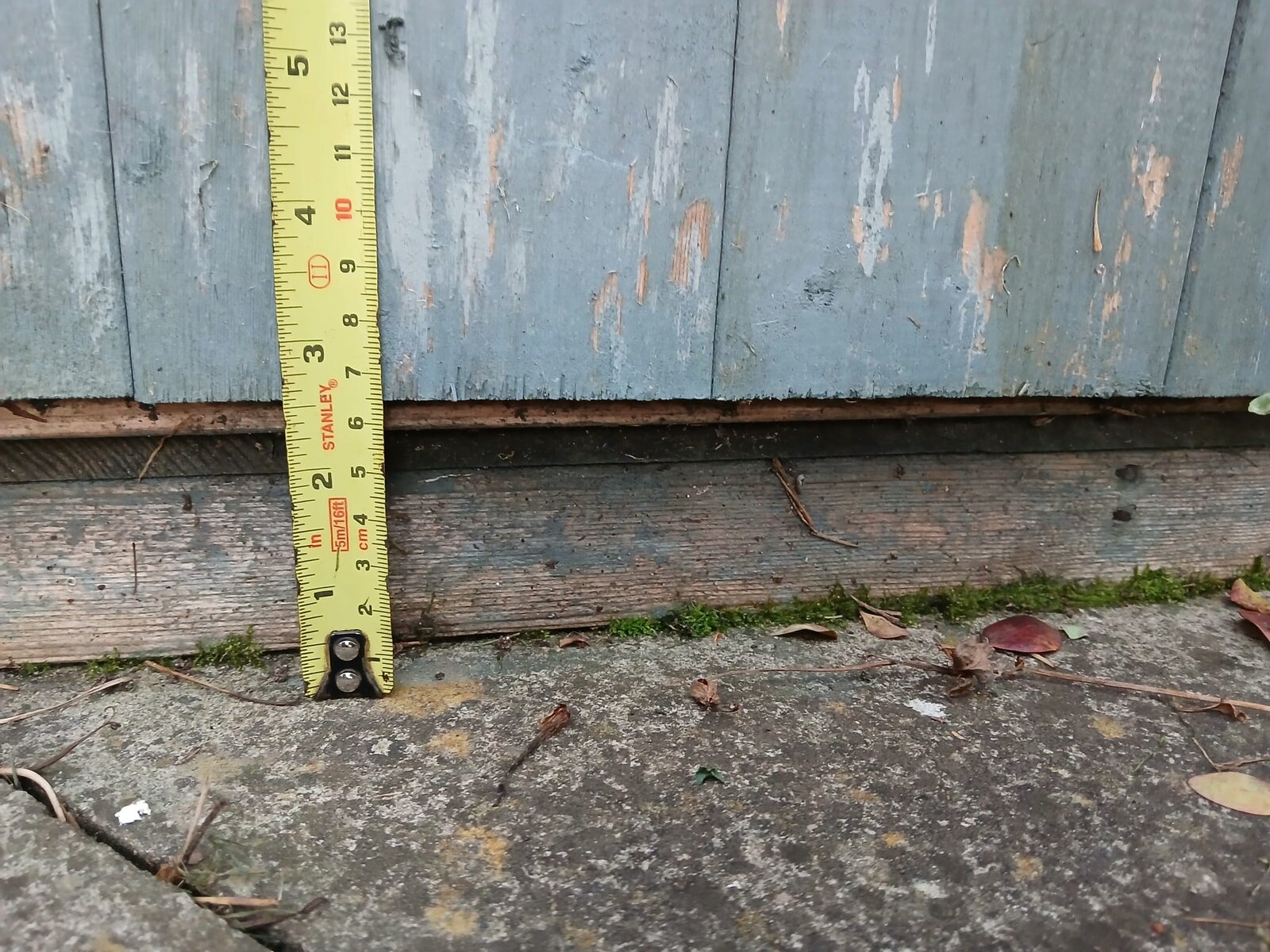

One other question please. I've just noticed that the shed sits on a frame with no air gap (batons are enclosed with wood frame on all sides)
The batons run side to side, so I was thinking of drilling a 32mm hole at the end of each baton run, to allow air under the floorboards. I can't see any other way of getting air circulation under the shed, and it's definitely retaining damp!

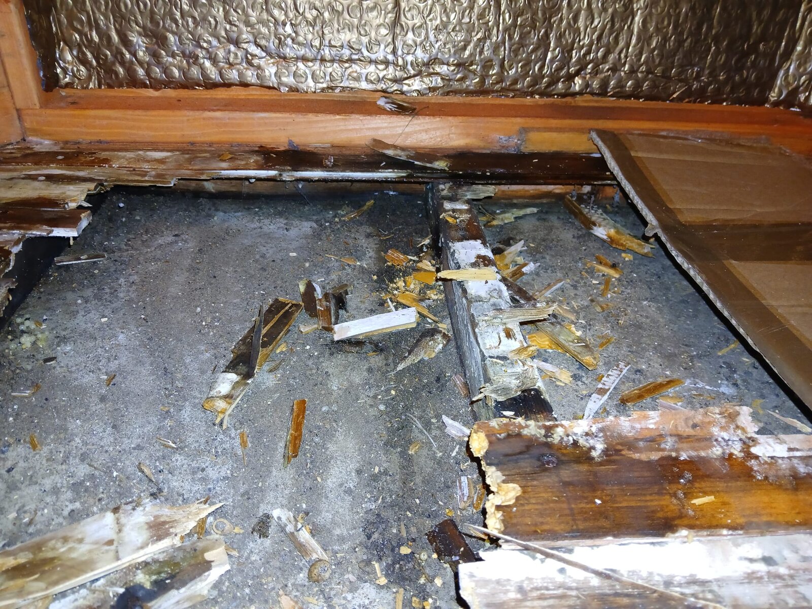

I lifted the carpet up and oh my some of it is in poor shape.
The plan is to add lots of vent holes and let it all dry out. Then replace the rotten batons and floorboard sections
Then add damproof on top of the floorboard, additional batons and celotex, laminate on top...

you need the sides to cover the base
get yourself some 2L pop bottles cut the top and bottom off then cut full width along the tube
cut 65-75mm bands and force between base and plank sides around 25mm [vertical behind plank and timber behind]
you can try dpm rolls but thicker and less stiff so harder to get in the gap
