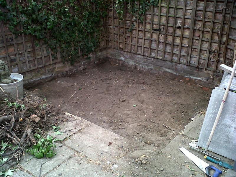

I'm building a shed in my patio garden. I've never done anything like this before so thought I'd bounce some ideas off you guys. I'll also update the thread with photos as I go along so others can benefit from the advice dispensed to me.
I've looked at bigall's photos of his shed and I'd like to end up with something just as nice.

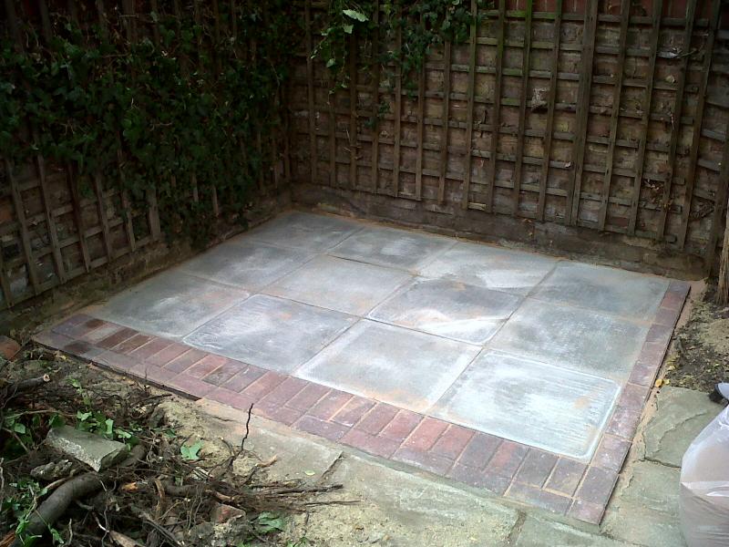

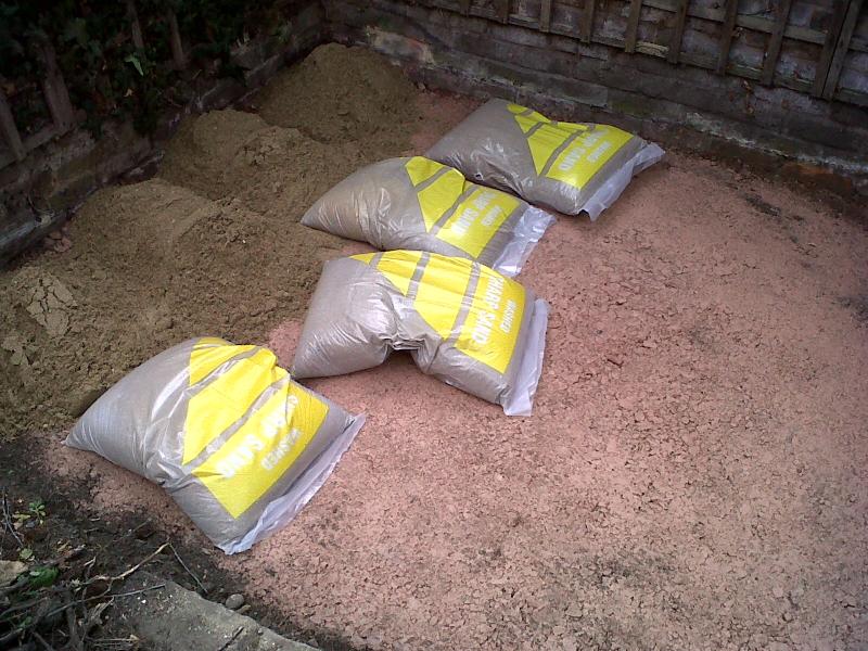

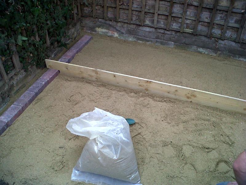

I completed the base yesterday. I dug out a lot of earth, wacked down 50mm of Type 1 followed by 50mm of sharp sand. This was then screeded over with a thin layer of sand before 600x600x50mm slabs were laid, edged with paving bricks. The edges were pointed in and the gaps filled with kiln dried sand. I'm very pleased with the result and am slightly disappointed to be covering it up with a shed!

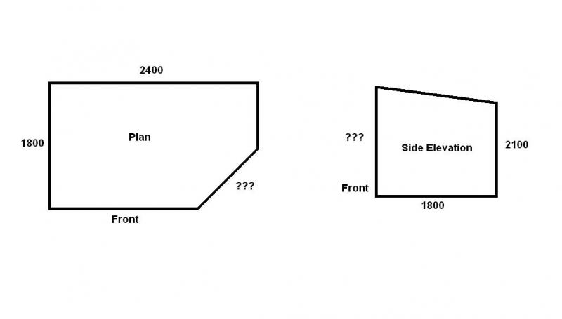

The garden is very small and the shed will take up about 10% of the space. In order to reduce the visual impact I was going to install the door across the corner. What sort of size opening should I go for?
What sort of roof angle should I be aiming for? I was going to make the rearmost side 2100mm high and would like the front to be as close to that as possible.

I would not loose the corner for aesthetics, just put the door on the end .You don't have much space why waste it. :?:

I'm going to lose the cut off corner - it'll look rubbish and be a pain the arris to fabricate. I'm also going to go with felt on the roof as shingles are not suitable for the low pitch I'm going for.
I'll sketch up some plans that'll allow me to determine how much timber I'll need.

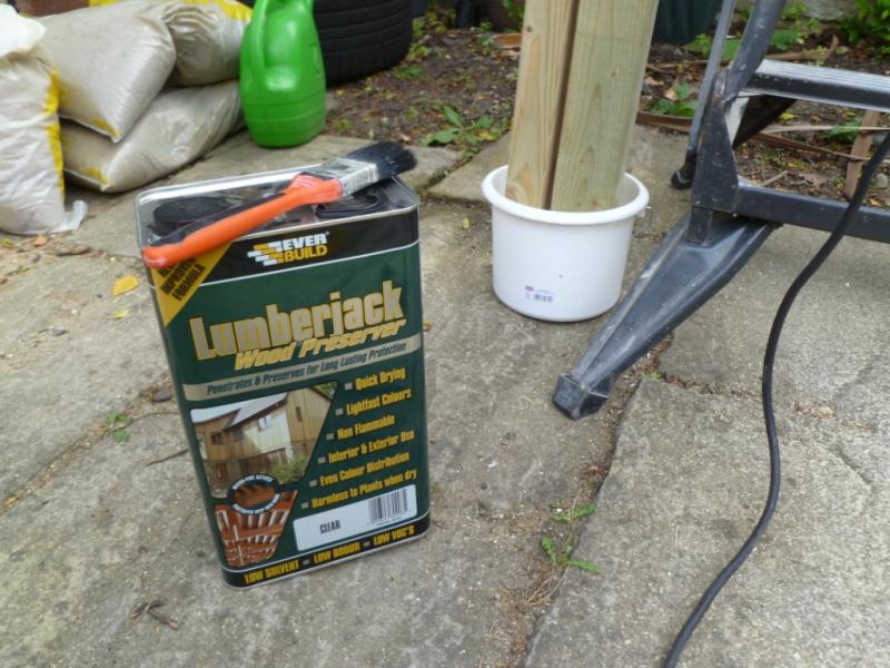

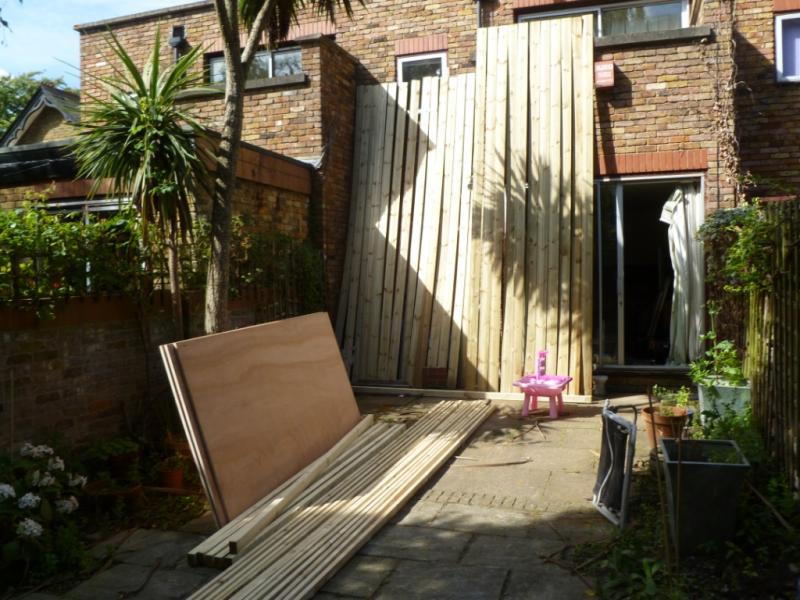

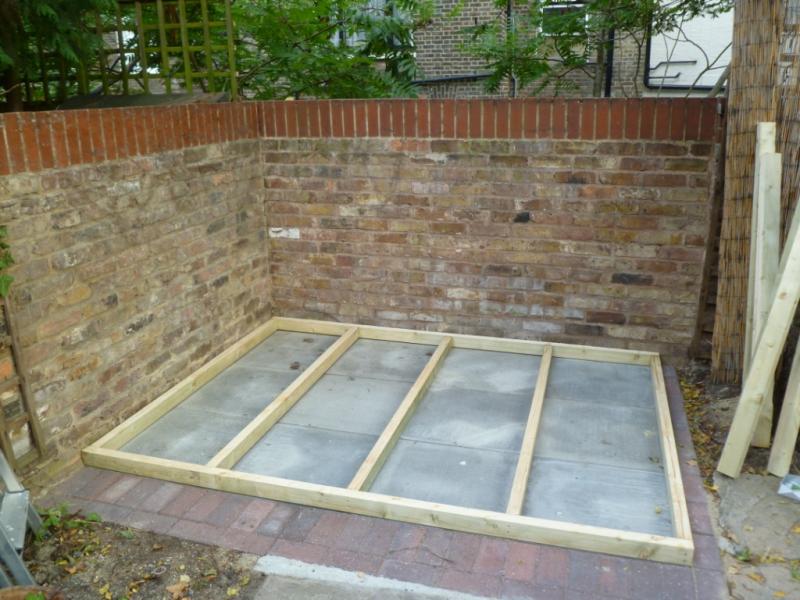

Timber arrived - it was a little damp so I've stood it up in the sun to try and dry it out as much as possible.

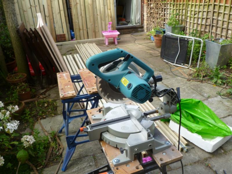

I borrowed a mitre saw from the FiL - it's a lovely bit of kit and going to save me a lot of trouble with the hand saw.
Cut ends are soaked in clear wood preserver.
I managed to make the base - 2x3 treated timber at 600mm centres.

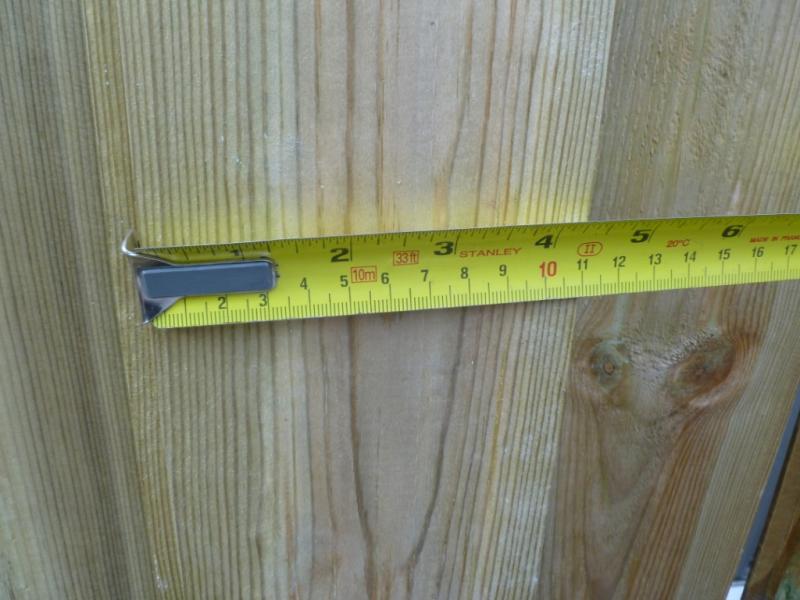

One question - I've measure all of my shiplap as shown. All pieces measure between 109mm and 111mm. Does this mean it is damp and needs to be packed together or dry and spaced apart?
Cheers!
107mm need 2mm spacers 109 spot on 111as tight as you can get it
you need all timbers off the floor or risk problems later
only one fixing per board bottom 25%
Thanks bigall.
When you say I need "all timbers off the floor" do you mean the base too?!
