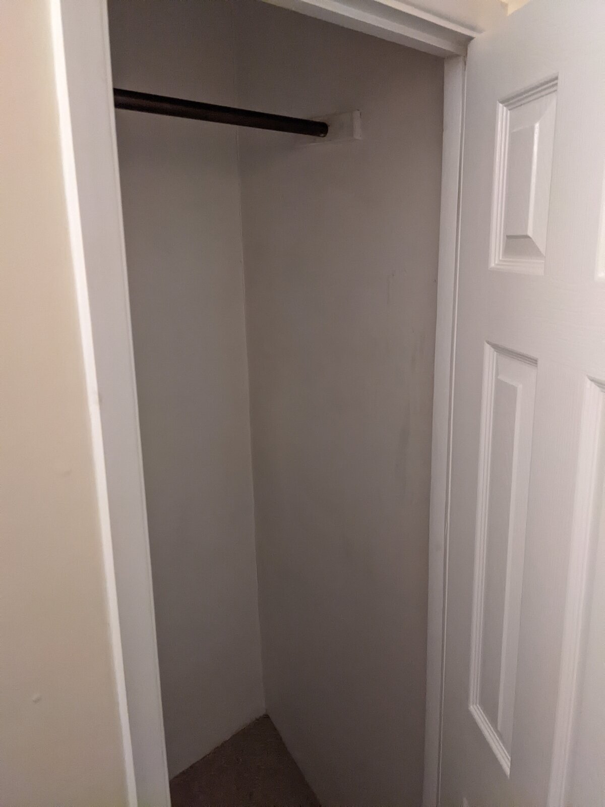

We have a cupboard above the stairs which you can see in the attached photo. I want to install some shelving. The back wall feels very thin, it's just a simple partition and I don't think it will take a rawlplug without it coming out the other side! I may be wrong about this but I'm planning on attaching the shelves to the two sides of the cupboard instead, which are solid walls and will definitely take more weight.
Each shelve will be 90cm long and 30cm-40cm deep. I'm looking for some advice on the most efficient way to attach the shelves to the walls. I was thinking about attaching four slotted uprights (so the shelves can be adjusted if/when needed) and using brackets. Is this the best way to do it and if so, where would be the best place to get the brackets?
And for the shelves, I was thinking about getting B&Q to cut some wood for me. Would MDF do the job? It doesn't have to be too aesthetically pleasing, more functional than anything.
I'm not the most talented DIY-er but shelves should just about be in my competency zone!
Any advice would be greatly appreciated!
TIA.

is this a cuboard above the stairs full width off the stairs or sharing with a room the other side each with a cupboard half-and-half ??

It's the full width of the stairs. As you're facing it, the right hand wall is the external property wall. The left hand wall dissects the smallest bedroom, so if the small bedroom was a full square, the cupboard takes up a quarter of the room if that makes sense?
is this a new build off unknown outer wall construction [possibly dot and dab ]or possibly old house with plasterboard attached to an uneven wall ??
but in general dependant on wall each side iff you use actual timber rather [possibly scaffold boards old or new] than mdf you wont need support on the back wall

yes but an unusual choice as they are designed for 15mm contiboard at perhaps 400-600 spacing will probably fully cope with 900 at 300mm depth off shelve but i prefer to overengineer to allow for redundancy
2x1 batons cost a few pence[£2a metre ish ] so £1 a shelf

It was because the OP wanted adjustable.

1950's. Okay, sounds like timber might be the way to go!
If you determine that the Side Walls are suitable, would Bookcase Strips do the job?

I'd agree.. timber. Build a frame inside the cupboard with it secured to the walls. The weight will be transferred to the timber and down to the floor as opposed to the walls.
So a batten frame with timber shelves sitting on the batten then?
If you determine that the Side Walls are suitable, would Bookcase Strips do the job?.
As B-A says, they are really designed to be fixed to a board, not an uneven wall, and the screw holes aren't big enough to take the size of screws you need to fix them to masonry (from memory most are designed for use with 3 or 3.5mm screws)
They also require notches to be made in the ends of the shelves
They would work if the OP could get a board fixed to the wall either side ofvthe opening, but the boards would need to be plumb and coplanar (i.e. same distance apart front and rear) for the moveable shelves to work
Personally I think I'd suggest 2 x 1 battens to the OP (drilled, plugged , screwed to the masonry, but what is on the other side?) with something like scaffold boards for shelves unless he really wants to carry heavy loads on the shelves, in which case it would need framed shelves
Happy with that, B-A? :)(y)
Yes. Any timber yard will sell you suitable timber to make the frame, then the shelves can sit on these. Something like 38mm x 38mm would be appropriate although I'd avoid looking for 'battens' as that wording is often reserved for roofing timber and you might struggle find the right dimensions.
To ensure it'll take a good amount of weight I'd have the shelves (made from ply or 18mm MDF) sat on lengths running at both the sides and the front/rear, so it doesn't bow.
