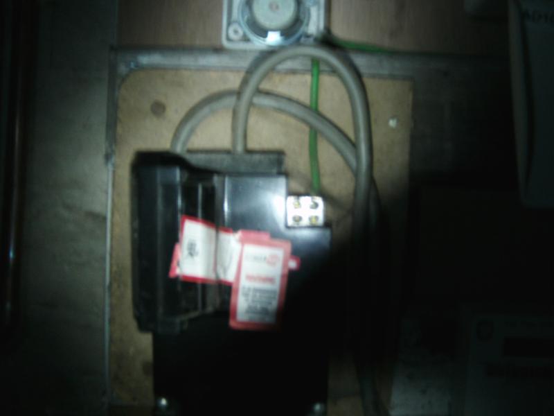

I was going to build a garage/workshop but bought a shipping container instead. I have read some threads on here regarding supplying electric to it, and would like more advice on how this should be done.
I include pictures of my supply. By the way I think my supply looks like it could do with upgrading, but when my new digital meter was installed I mentioned it and the guy said it was fine. Does it look fine to you ?
Cheers.
Were them pictures taken after the new digital meter was fitted?
Seems your meter man forgot to seal the cutout?
It also looks like the security sticker isn't broken so he hasn't pulled the fuse?
Cutout looks fine, can't see anything exposed it just looks like the cover is too high to cover everything.
The sticker is broken, It was already broken when I moved in, and the seal was also missing. ;)
But yes he seems to have forgotten to seal it. Which I am happy about.
Should the incommer be anchored to the wall ? It is basically dangling from the cutout.
Looks ok to me from the picture but I'm no cutout king.
Phone your supplier and tell them your CUTOUT looks unsafe.
They will get the mains fellas out to have a look and give it the once over that we can't from the picture.

I understand this work is notifiable.
Does this sound acceptable ?
Electricity supply to container.
2.5mm 3 core swa terminated close to cu in an adaptable metal box using gland.
Flylead from banjo inside box, run with the L, N and E, through a grommet, into the cu in trunking. This connected to a 32a mcb on the 100ma rcd side of the cu.
Through the wall in pvc conduit sealed on the outside with mastic.
Supported by catenary wire to the container.
Through the side of the container at the top in a 25mm Nylon Cts Gland.
Then the same setup in the container as in the house, but connected to a 30ma rcd in the cu.
Also will earth bond the doors to the main body then from there to the cu.
Any advice would be appreciated especially on the best way to exit the adaptable box with the swa leads to the cu. I think there will be a better way than a grommet. And the best cable to bond the doors to the main body.
Cheers.
