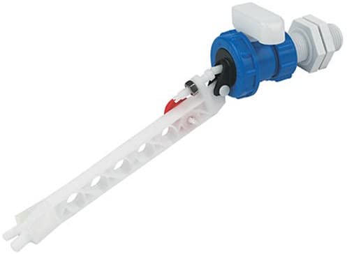

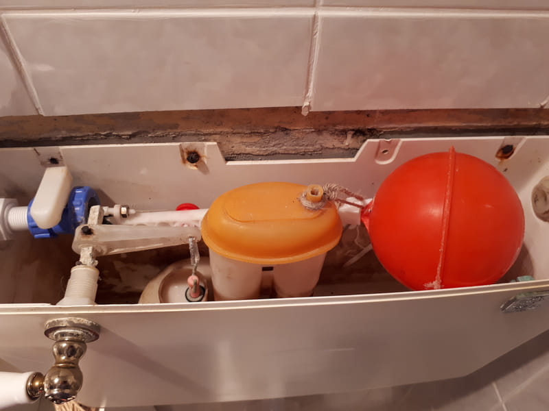

ordered a valve, adding 2 pics, hopefully they upload. first pic the new valve I have ordered and second pic is the inside of the cistern. this toilet and cistern are about 50 years old lol. PS the string you can see on the ball was only to tie it up for a few minutes to shut the valve off

No, I mean the float valve that is on the cold storage cistern (usually in the loft) (Big tank) that is separate from the wc cistern.
Edit: just seen that you've mentioned it's a combi boiler. In which case, the wc float valve should be set up for high pressure feed.

I changed the complete valve, not just the diaphragm, and in your words mate " FFS " its still the same, So changing just the diaphragm wouldn't have fixed it. Whats with the " FFS " no need for it, I was only asking for help, I would have changed it BUT because of the differences in noise turning on taps I asked for help. If you don't want to be polite and offer help what you doing on this forum ?
Water Hammer, the noise is caused by a washer vibrating, akin to a reed in a wind instrument. The water carries the sound through the pipework and amplifies it. Not necessarily the WC, I'd be looking at the stop tap if changing the WC Ballvalve hasn't solved it, (you may even feel a fine vibration from the stop tap when the noise is occurring.) Try turning it down and see if that helps.
