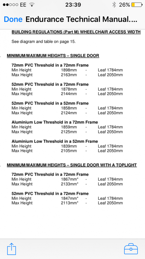

Anyone know of any companys that make composite doors shorter than 1950mm?
Both of my main suppliers Doorstop and Solidor its around 1950mm min with cill and low ali thresh.
Seems a bit silly they cant do smaller and I have had a few recently that needed it, Current one I would like to price is 1900mm.

Ours can go to 1889, low Ali on a sill
Endurance Doors (Rocal)
If you want a solidor made contact Michael Hagan Aztec Windows in COVENTRY.
1980 on ali cill, can go further into the reinforcing to gel 1900 but then can't guarantee

I have spoken to someone at Rockdoor and some of theirs go down as low as 1722mm.
Also after pointing out to my Solidor supplier that its that its silly they cannot go smaller as they don't have the foam issues of other makes he thinks he may be able to do it with a different locking system, So he will get back to me.
