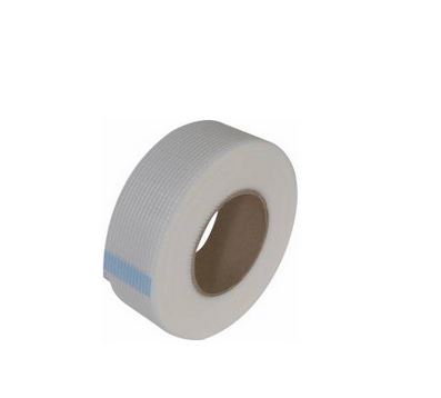

You know what your taking about job and knock. I've got some sound isolation tape to put on the studs where they are being fixed to the wall, floor and ceiling. I've got acoustic sealant for the edges. What is scrimming? My plan was to treat the first layer like the last. Seal the edges and joints with acoustic sealant before applying the second layer. With it being so air tight do you think moisture will be a problem?
What is scrimming?
Plasterer's self-adhesive scrim tape:
Laid across the joints before filling them with plaster or jointing compound - gives the plaster/filler something to adhere to. Alternatively you could just caulk the joints on the first layer with silicone or acoustic filler. The main thing is to seal any gaps
