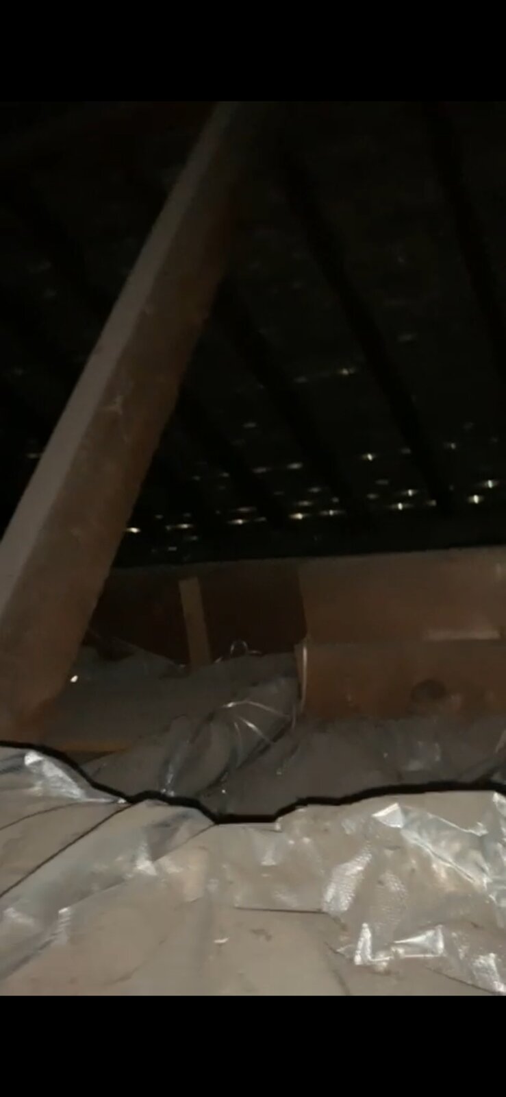

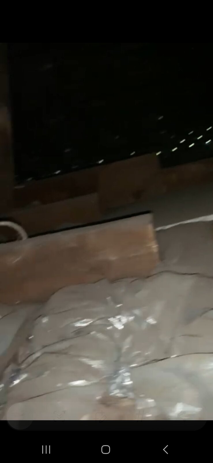

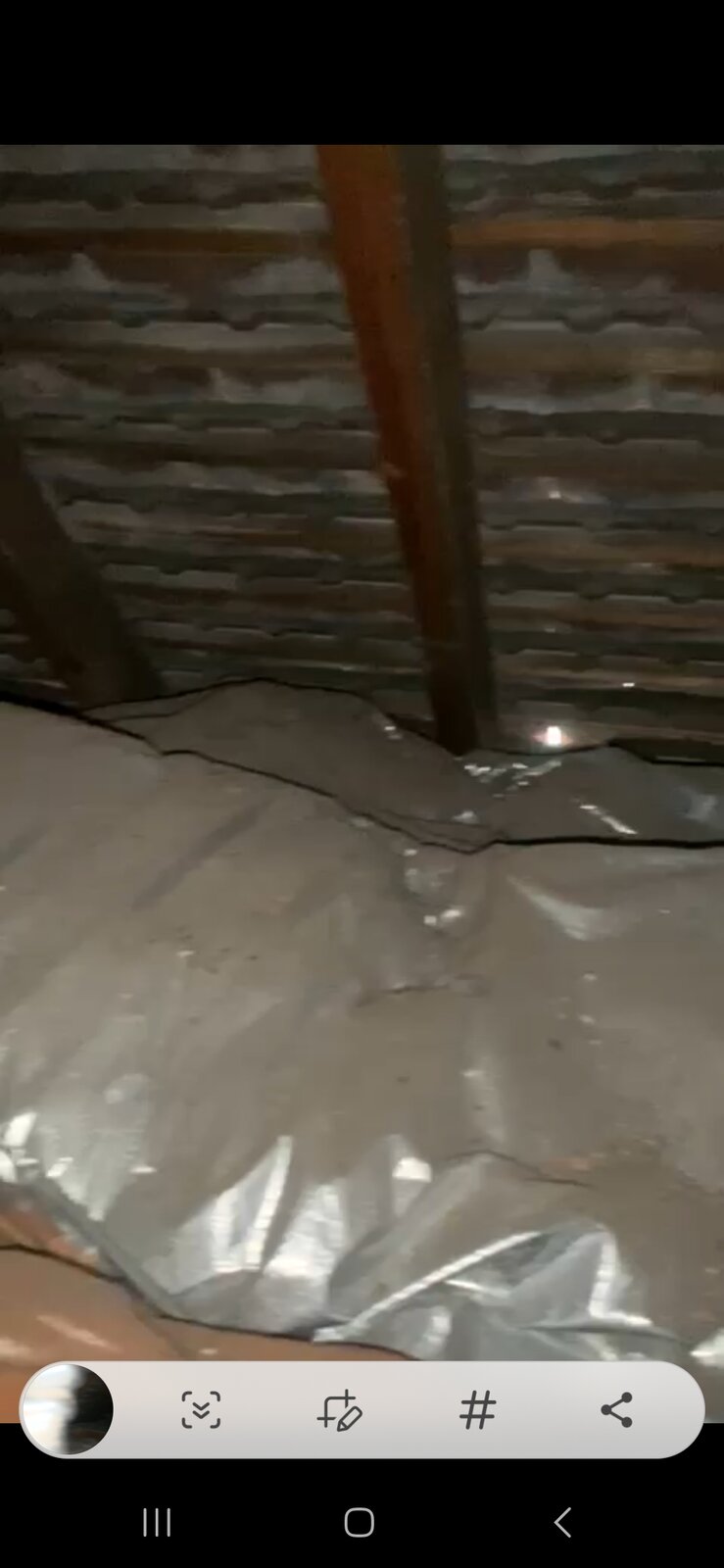

Hello, we're in the process of purchasing a home and noticed day light coming through. Wandered if this was normal or something we should be worried about? It would be appreciated if anyone has any guidance/advice.

no, it means nothing
the pics are too bad to see, but it looks like clay tiles with maybe lime mortar holding them in place
is it a very old house
