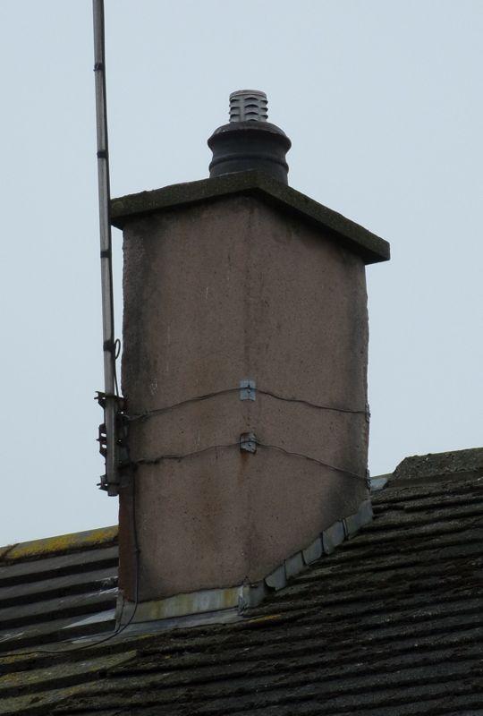

Should I be worried about this missing rendering ?
4 Nov 2010
6,388
712
Cumbria
I'll be having a new TV aerial put up before too long - properly, not like this one :roll: Before I do, should I be too worried about the bit of missing rendering ? SHMBO tells me it's been missing for quite a few years, and a builder she had do some other bits round the house told her not to bother with it - though she does think that perhaps he just didn't want the hassle.
Also, any suggestions for a ballpark cost to have it fixed - it's on a 2 storey 1960s ex-council house ? If it's going to be out of our budget at the moment, I won't waste anyone's time getting them round to quote for now.
I'm thinking "it needs fixing sooner or later".
PS - apologies for poor picture, I've misplaced my camera and had to use the phone :oops:

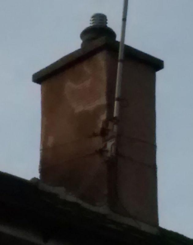

Suggest that you post focused pics from various elevations.

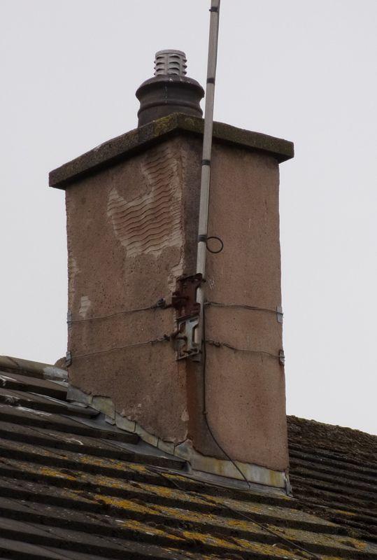

The render has been previously repaired & looks to be absorbing moisture.
Galvanised corner plates are available to protect the outside corners from the cables.
The concrete flag that's capping the stack doesn't have throatings to allow for drips.
The flashings are a bit untidy.

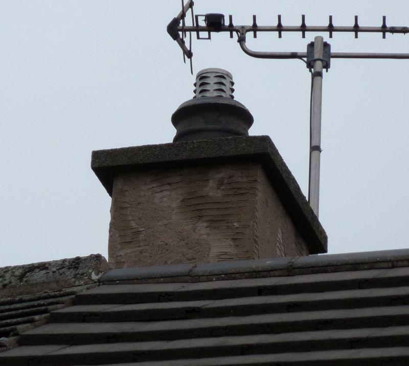

The stack render is absorbing moisture. Areas have been scratched ready for a top (missing) coat.

To render correctly all the render must come off back to the brickwork. Your stack probably has perished brickwork.
Plan any work you want the least amount of travelling on your fragile roof - roof ladders/crawlers must be used.
The flue prior to the gas fire may not have been swept - hence, soot is now degrading the flue and stack brickwork, plus moisture was entering thro the original flaunching (thats why a flag cap has been installed).
There's probably a number of flues terminating in that stack - they will all require venting and sweeping.
If the gas fire has a liner then you cant sweep the flue without removing the liner.
