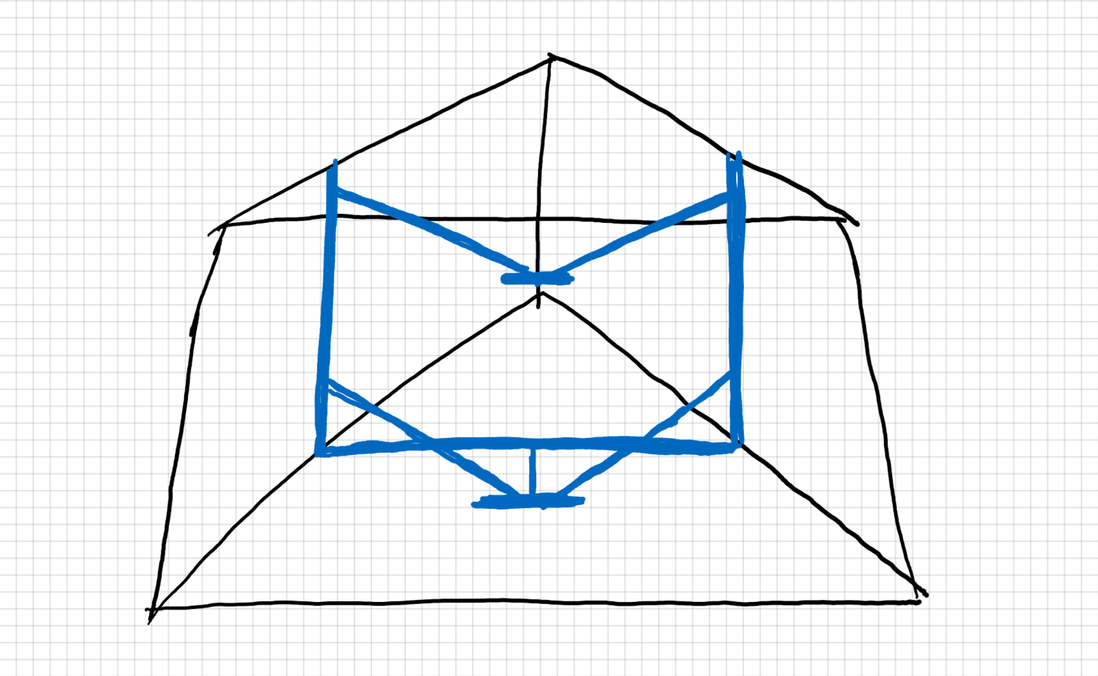

I'm new to this forum and am looking for some advice regarding my loft.
I live in a 1930s semi-detached with a hip roof and wasn't sure how to describe the truss layout, so I drew a dodgy diagram!
The plan is to convert the loft properly at a later date, with a hip-to-gable (if possible) and dormer, but for now I'm just looking to make better use of the space for work. But that needs a design that provides open floor space (even if it's small) and the current truss system makes that impossible as the supports come into the middle of the space.
Would there be a relatively simple way of restructuring the truss system without having to add new RSJs and so on?

The works require BC approval so you will need to employ an SE to do the design and calculations who is very likely to specify steel beams to take the load from the roof and the new floor.
I am only a DIYER but please don't be tempted to remove those inconvenient structural struts you call trusses. Your roof could collapse.

Thanks.
I definitely have no intention of doing anything without an expert opinion and have already got contact details for a structural engineer.
Just wanted to check if anyone had any experience of doing anything similar, to see whether there is a simple solution or whether they had no choice but to get new steel RSJs, etc. If it's the latter, than I'll probably leave it for now!
Will probably have no choice but to get the SE's advice.
Yes you will need new beams to replace any that you remove or want to relocate
