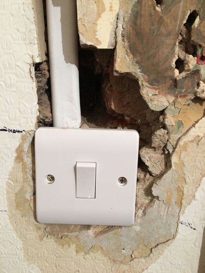

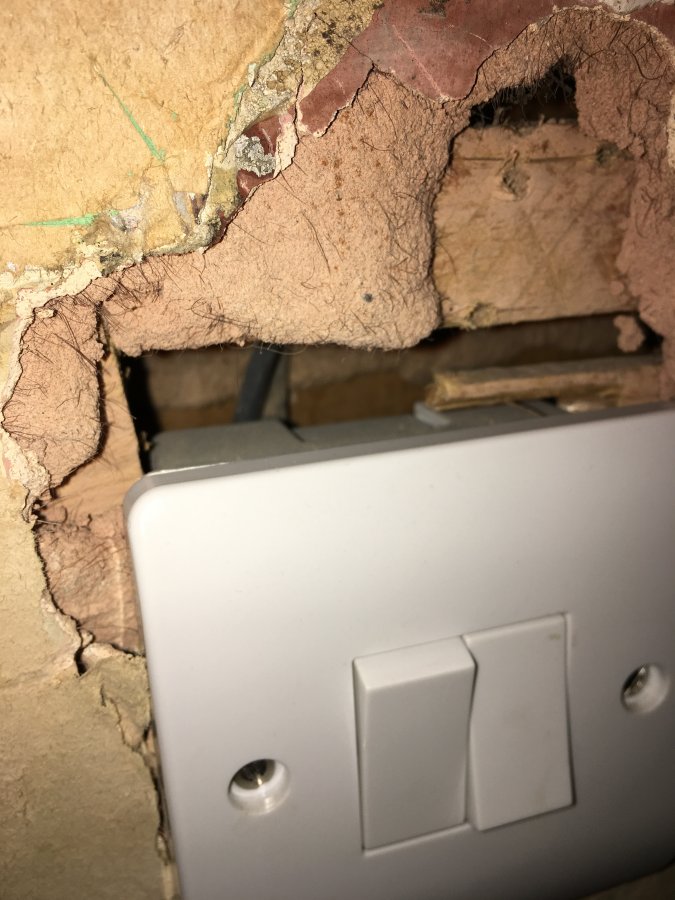

Thanks all....
I've checked the quote and as I predicted there was no mention about decorating.
The socket is a bit loose in the wall tho and would have thought he would make it a bit more solid than what how it is now but maybe that's my job! Here's a pic to show you what I mean.
Nope! He made those holes! Thats why I'm so surprised and thought Id ask you guys....
Unfortunately there will often be a lot of damage when chasing walls in very old houses.
The plaster just crumbles away.
Before second fixing (ie fitting the switch and socket faceplates), the electrician should have asked you who was going to do the plastering.
It's a bit of a bad job doing the second fix before the plastering, as all the crud ends up all over the faceplates and in the terminals.
Most electricians aren't plasterers, so some wouldn't necessarily make a good job filling the chases.
On a largeish job such as yours, the plaster repairs should really have been done before connecting, even if someone had just put an initial bonding coat on, if semi-skilled, just to keep things a little tidier.
