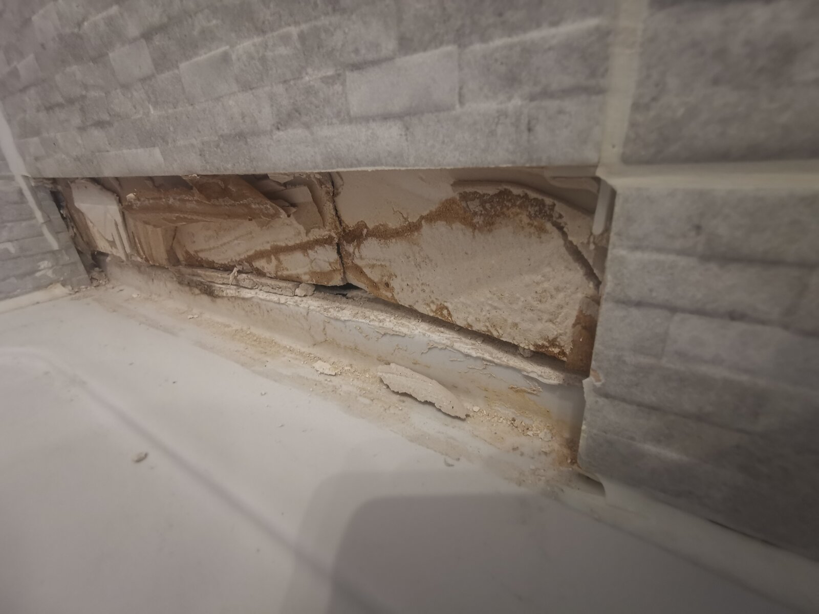

A tile has come off in the shower cubicle on a new build, tiler is coming with a new tile to repair but I'm concerned the board behind is damaged and water will eventually get behind the tile again.
Does the board need repairing first for a proper job?
cheers
What is protecting the substrate from water damage?
BS 5385 now recommends a tanking or other waterproofing system even in residential wet areas.
Considering they grouted over a spacer aswell as whatever caused this tile failure I would not be confident in the rest of the work.
